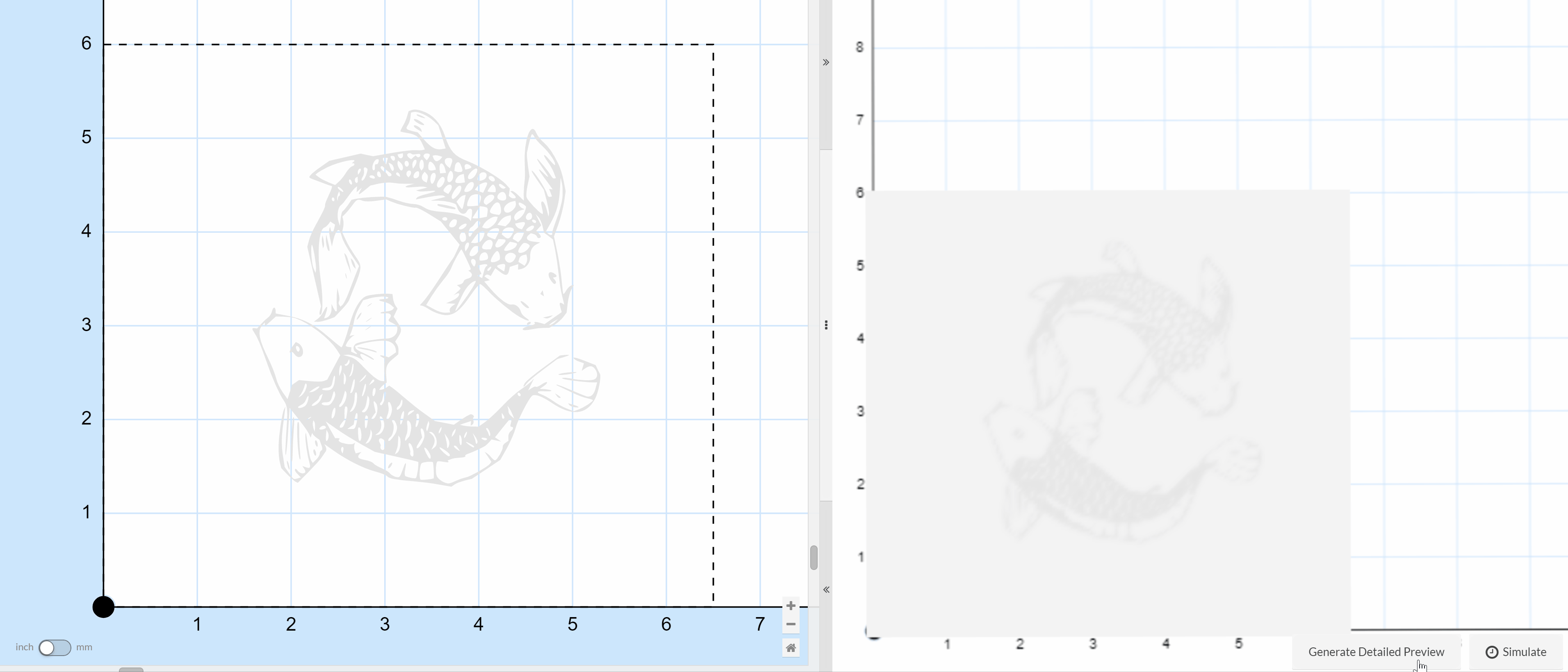

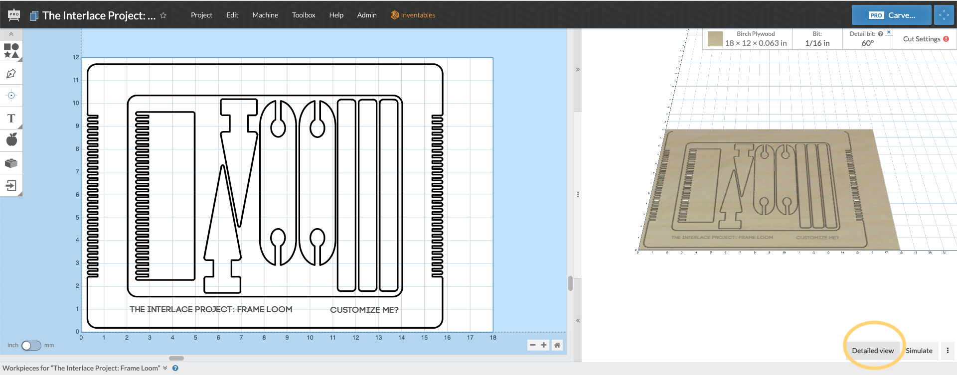

For most Easel projects, the HD preview will automatically generate in the 3D preview pane on the right side of Easel’s interface. However, more complex projects require you to click the “Generate 3D Preview” button at the bottom-right of the screen (next to the “Simulate” button).

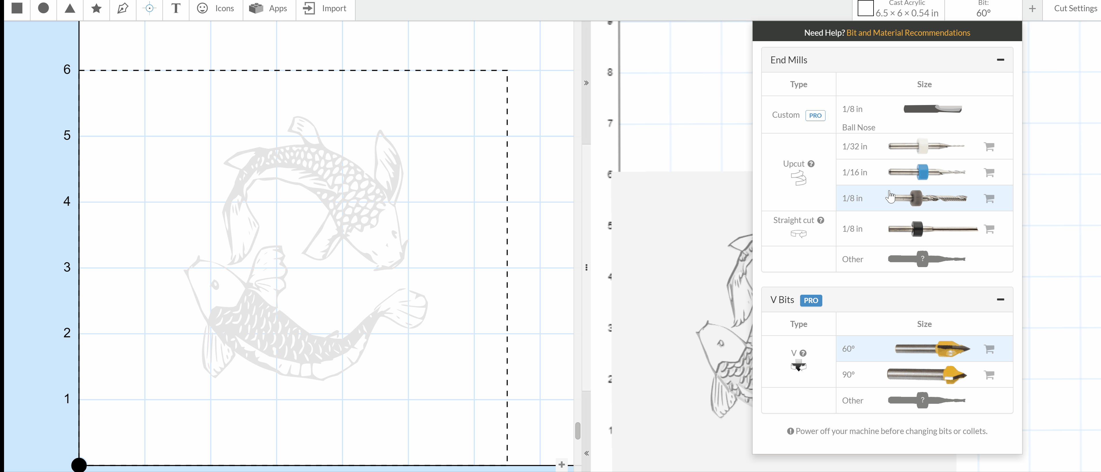

For starters, you can clearly see when a bit will not carve part of your design. This is called an "Uncut Area" and you will see it as missing parts of the design. This is important if you are using a larger bit with a lot of fine details. Using the detailed preview feature helps you see when a bit is too large to fit into your design.
