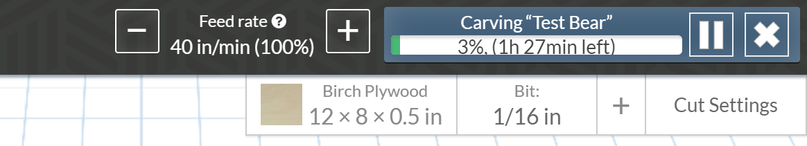

- Click Raise the bit (1) to lift the bit off your material.
- Keep your hands clear and click Turn on the spindle (2).
- Once the spindle is running, click The spindle is on (3).
- Click Carve! (4) to start.
