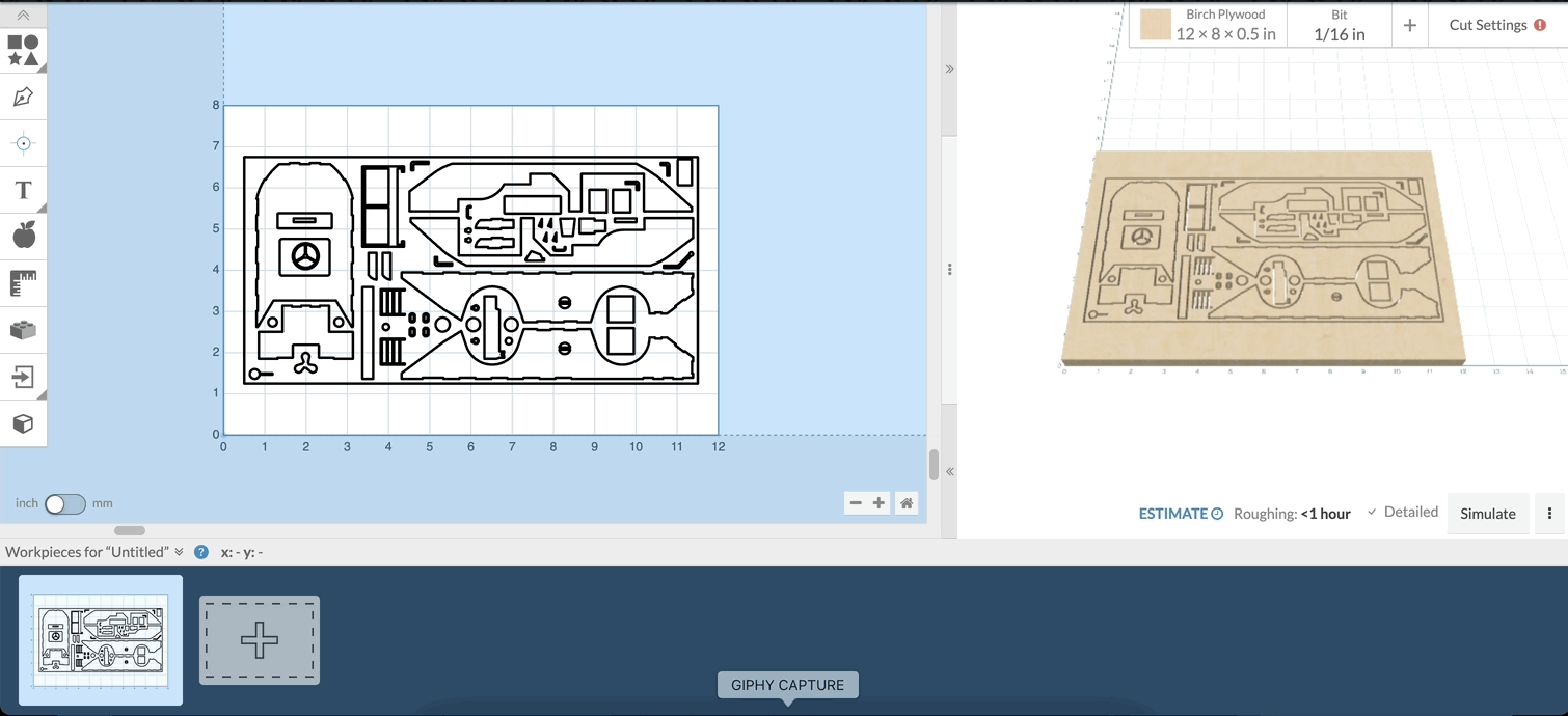

| Helpful Tip: Run a toolpath simulation before you clamp. It shows where the bit will cut, so you can put your clamps out of its way. |
In this example, the outline toolpath (1) runs close to the edges of the design, and the bit moves to and from the front-left corner (2) between cuts. Keep your clamps clear of both.
