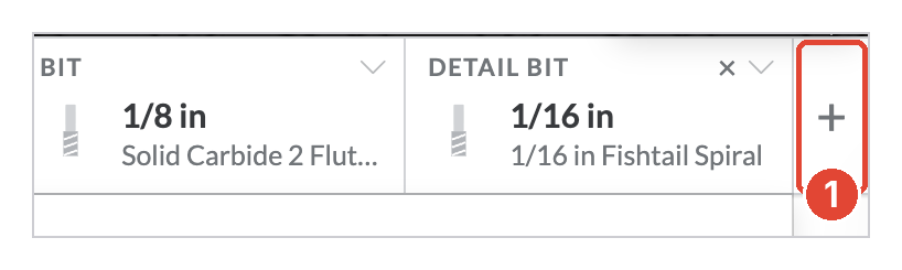

The Outline Bit feature allows you to add a third bit to your carving specifically for outline vector toolpaths.
Previously, Easel always used your detail bit for outline cuts — including final cutouts — even if that bit was a small V-bit or a 1/32" bit. This often caused slow carves, broken bits, or required complex workarounds.
With the Outline Bit, you can:
Select a separate, sturdier bit (like a 1/8" or 1/4" end mill) just for outlines.
Avoid duplicating workpieces or manually hiding shapes.
Run your entire carve with three distinct toolpaths: Roughing, Detail, and Outline.
Cut out your design more efficiently and reliably.

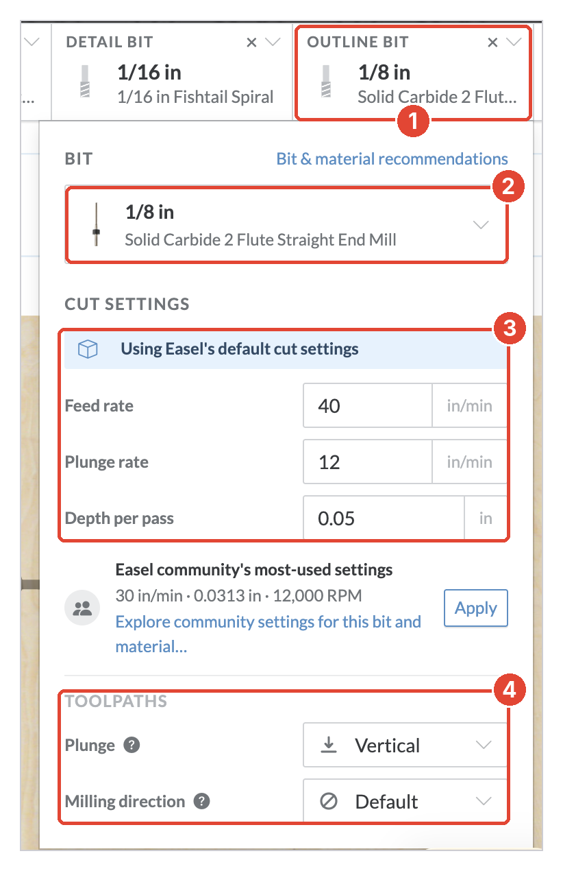

How to Use the Outline Bit
Benefits
Faster carve times with the right tool for the job.
Reduced risk of broken bits during outline cuts.
Simplified workflow with no need for duplicating workpieces.
Cleaner, more reliable cutouts.
| Helpful Tip: For best results, choose a robust bit such as a 1/8" or 1/4" end mill for your Outline Pass. |
