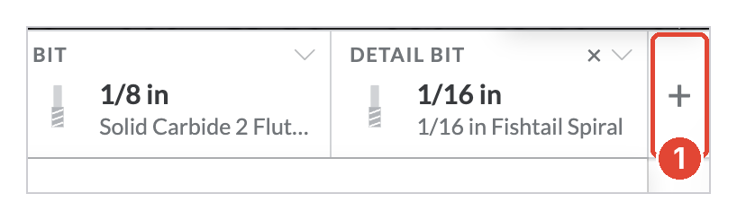

Click the + next to your selected bit and choose Drill Bit.

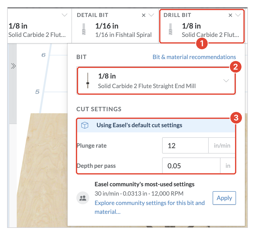

- A Drill Bit tab (1) appears in the settings bar. Click it, then choose your bit from the drop-down (2).
Review the Cut Settings (3). A drill pass only plunges, so you only need to set the Plunge rate and Depth per pass.
