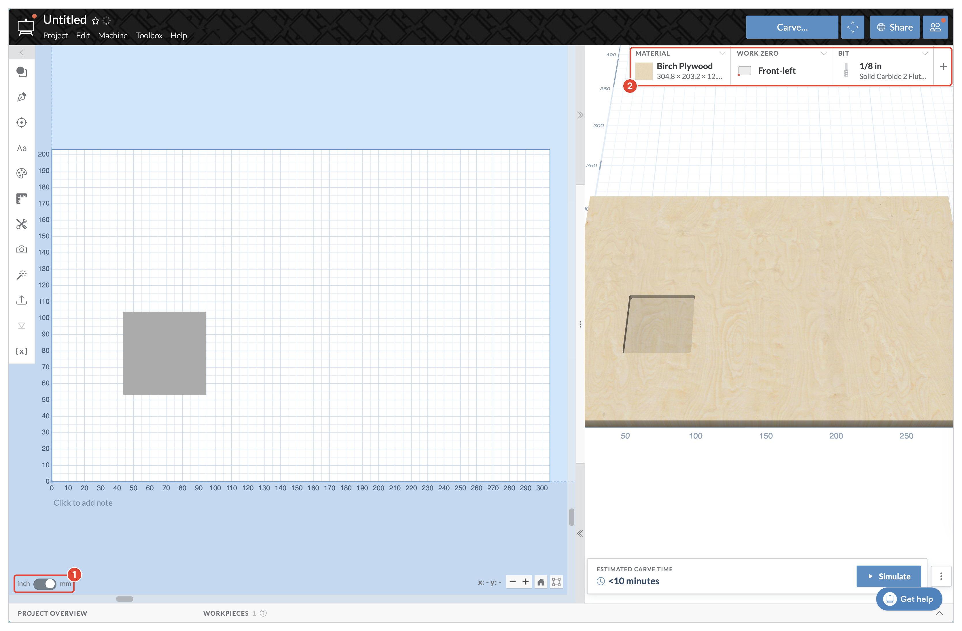

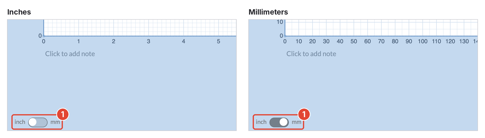

In Easel, you have the option of using imperial or metric units. You can change between inches and mm by clicking the toggle (1) on the lower left-hand corner. This will change all of the units in the project.
You will also notice other fields where dimensions can be entered. For example, when selecting an object you will see the Shape/Cut menu pop-up.
- In the Shape menu, you can adjust the Position, Size, and Rotation of the selected object by entering a value.
- In the Cut menu, you can adjust the depth by entering a value or using the slider.
On the top right-hand side, you will see the Material, Work Zero and Bit menus (2).
