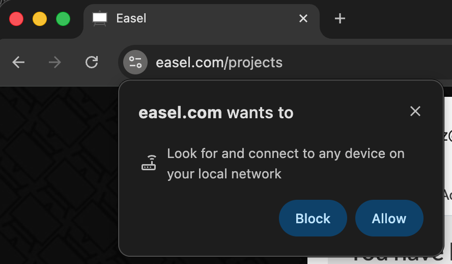

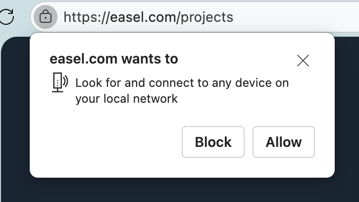

Updated versions of Google Chrome (version 142 or newer), Microsoft Edge (version 143.0.3650.66 or newer), and Mozilla Firefox (version 153 or newer) have added a new permission setting that requires users to manually allow websites to access local networks. This permission is required to allow the Easel website to find the locally installed Easel Driver to connect with machines.
Upon opening the Easel website, you may see a prompt asking whether to allow or block Easel from looking for and connecting to any devices on your local network.
You'll need to allow this connection so Easel can safely communicate with your machine:

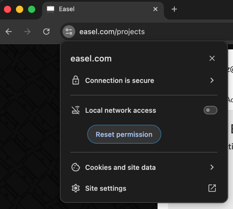

- If you accidentally dismissed or denied this prompt, you can reset the permission by clicking the lock or settings icon next to the Easel.com address in your browser’s address bar. From there, re-enable access to local devices and then refresh Easel before trying to connect again.

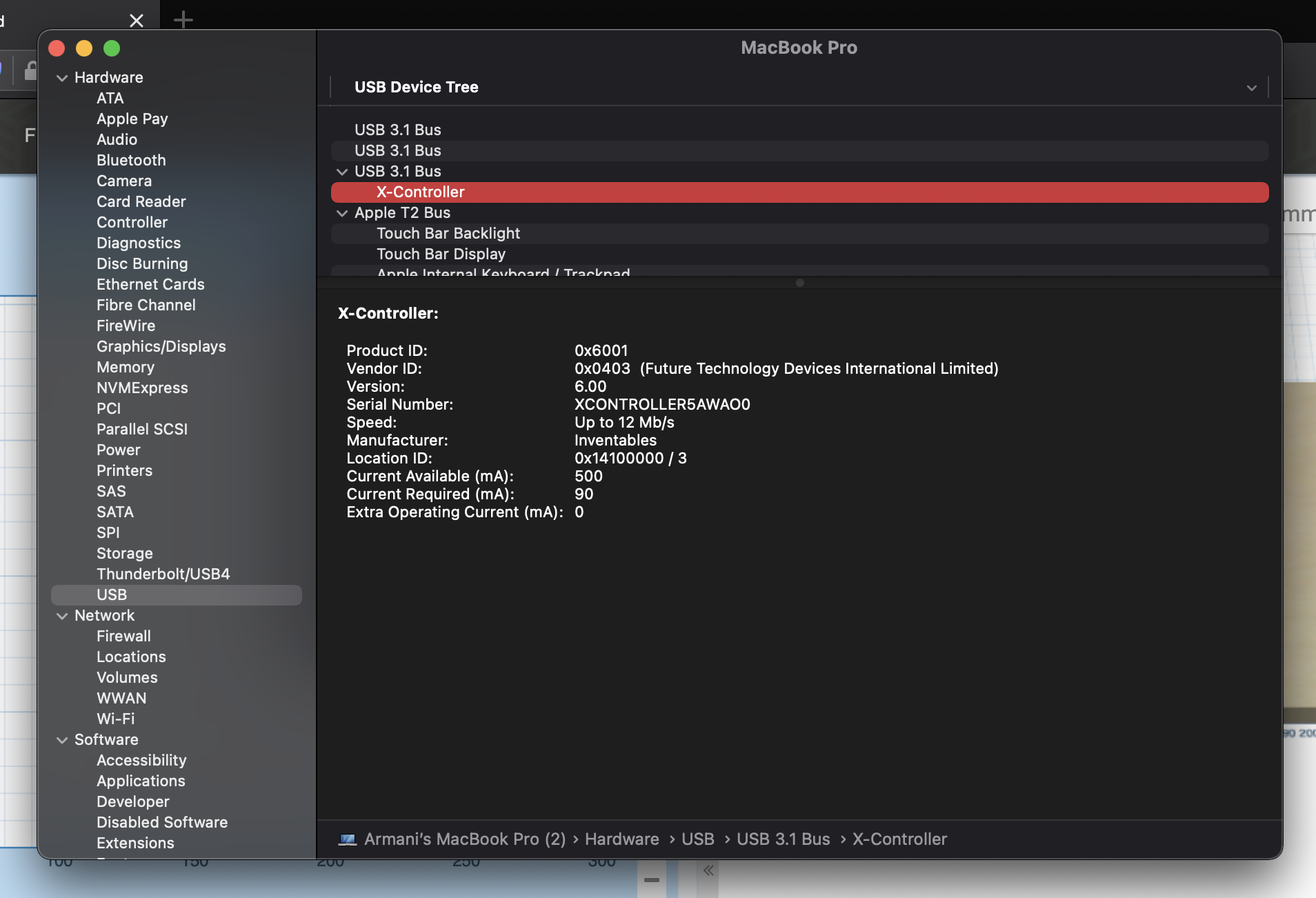

3. Make Sure macOS Detects the Controller
- Hold ⌥ Option, click the Apple menu, and choose System Information.
- Select USB in the left sidebar.
Plug in the machine’s USB cable and watch for a new USB‑Serial (or similarly named) device.
What you see What it means USB‑Serial device appears macOS is talking to the controller—great! Nothing appears Cable, port, or controller power problem. Re‑check basics from Step 1.
If the device appears in System Information yet Easel still can’t connect, a conflicting driver is almost always to blame—see the next section.

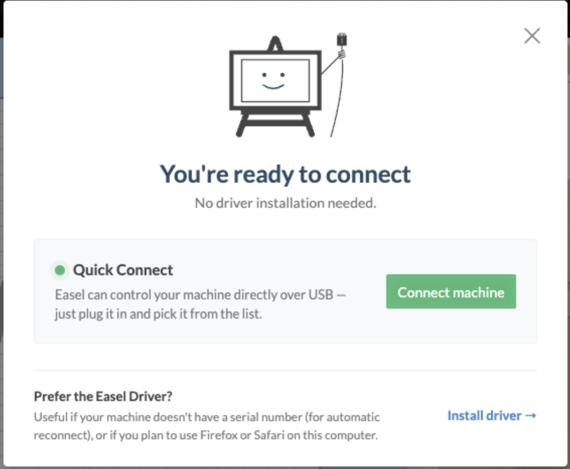

- Open Easel and click Carve.
- A new connection screen will appear.

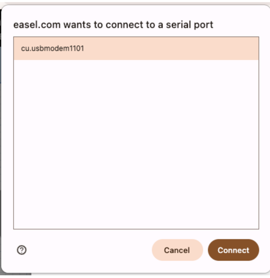

- Click the green Connect Machine button.
- Your browser will display a list of available ports and devices.
- Select your machine from the list.
- Click Connect to authorize Easel to communicate with the machine.
Once connected, you can begin carving as normal.

Some machines provide a unique identifier to your computer. When using these machines, Easel may automatically reconnect to the device in future sessions.
Other machines require you to authorize the connection each time the device is plugged in. If you prefer automatic connections and your machine falls into this category, you can install the Easel Driver instead.
