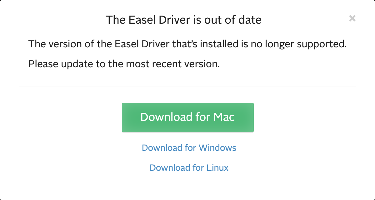

As we work on improving Easel, you may be prompted to install the new Easel Driver.
Before you get started, please ensure your computer meets the minimum system requirements listed here: What are Easel's System Requirements?
You can find the latest version on the Easel Downloads page.

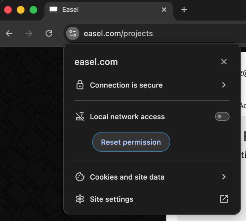

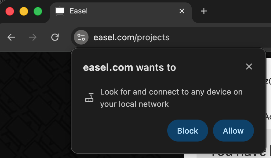

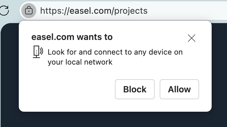

FOR GOOGLE CHROME AND MICROSOFT EDGE USERS:
Updated versions of Google Chrome (version 142 or newer) and Microsoft Edge (version 143.0.3650.66 or newer) have added a new permission setting that requires users to manually allow websites to access local networks. This permission is required to allow the Easel website to find the locally installed Easel Driver to connect with machines.
Upon opening the Easel website, you may see a prompt asking whether to allow or block Easel from looking for and connecting to any devices on your local network.
You'll need to allow this connection so Easel can safely communicate with your machine:
- If you accidentally dismissed or denied this prompt, you can reset the permission by clicking the lock or settings icon next to the Easel.com address in your browser’s address bar. From there, re-enable access to local devices and then refresh Easel before trying to connect again.

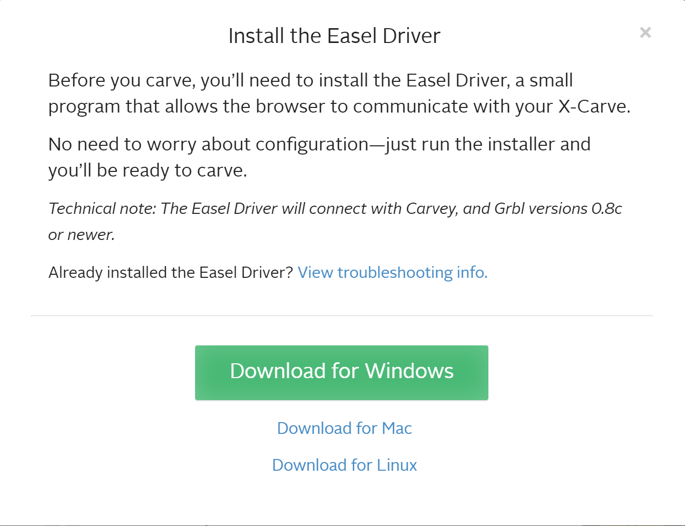

If you are prompted to Install the Easel Driver and you will see this pop-up:
1. Click the green Download for Windows button, the Easel driver will automatically download to your computer. Most downloads are saved to the Downloads folder.

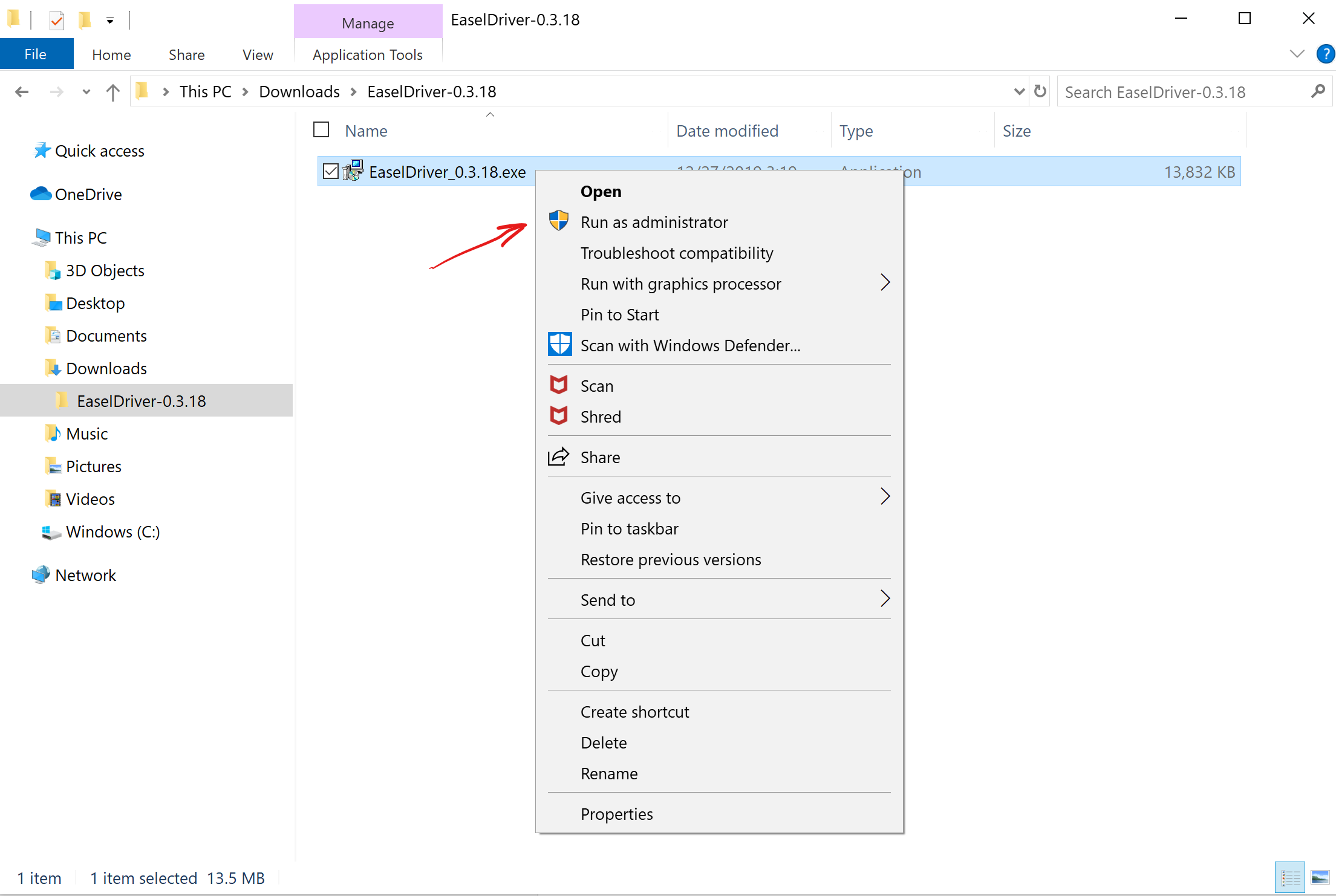

2. Go to your Downloads folder, open the download and you should see the file EaselDriver-0.3.18.exe.
3. You need to right-click the EaselDriver_0.3.18.exe, select "Run as administrator" and follow the installation prompt. (If you do not see this window, go back to Downloads and double-click the EaselDriver File Folder to open.)
Windows 10 security settings may pop up to confirm if you want to install the driver. You will need to click "More Info" and select "Run Anyway" to proceed with the installation.

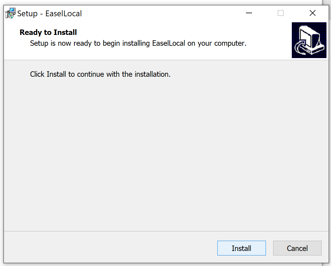

4. Follow the Installer instructions to complete the installation. You may need to refresh your browser and, in some cases, restart your computer.

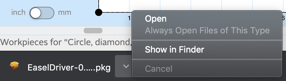

1. Click the green download button. The Easel driver will automatically download to your computer. You may also see the download at the bottom of your browser.
2. Click the EaselDriver-0.3.18.pkg file and open it to run the installer.
3. Follow the Installer instructions to complete the installation. You may need to refresh your browser and, in some cases, restart your computer.

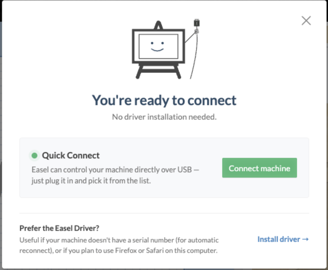

Connecting without the Easel Driver
Overview
Easel can connect directly to compatible machines without requiring the Easel Driver. This option is useful for older computers, Chromebooks, or environments where installing software is not possible.
Important: Driverless connections are only supported in the following browsers:
- Google Chrome
- Microsoft Edge
- Opera
Before You Begin
To use a driverless connection, the Easel Driver must not be installed on your computer.
If the Easel Driver is currently installed:
- Uninstall the Easel Driver.
- Restart your computer to complete the removal process.
- Open Easel in a supported browser.
Connecting Your Machine
- Open Easel and click Carve.
- A new connection screen will appear.
- Click the green Connect Machine button.

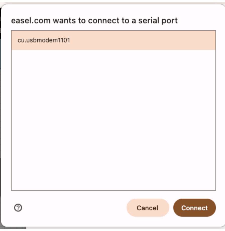

- Your browser will display a list of available ports and devices.
- Select your machine from the list.
- Click Connect to authorize Easel to communicate with the machine.
Once connected, you can begin carving as normal.
