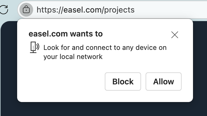

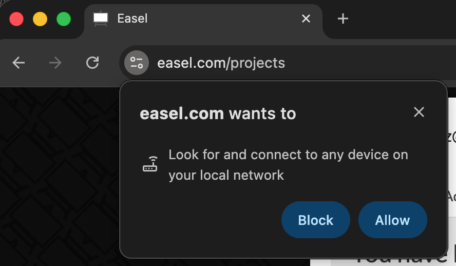

FOR GOOGLE CHROME, MICROSOFT EDGE, AND MOZILLA FIREFOX USERS:
Updated versions of Google Chrome (version 142 or newer), Microsoft Edge (version 143.0.3650.66 or newer), and Mozilla Firefox (version 153 or newer) have added a new permission setting that requires users to manually allow websites to access local networks. This permission is required to allow the Easel website to find the locally installed Easel Driver to connect with machines.
Upon opening the Easel website, you may see a prompt asking whether to allow or block Easel from looking for and connecting to any devices on your local network.
You'll need to allow this connection so Easel can safely communicate with your machine:

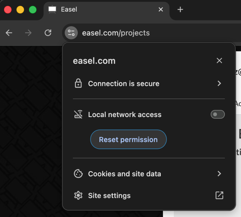

- If you accidentally dismissed or denied this prompt, you can reset the permission by clicking the lock or settings icon next to the Easel.com address in your browser’s address bar. From there, re-enable access to local devices and then refresh Easel before trying to connect again.

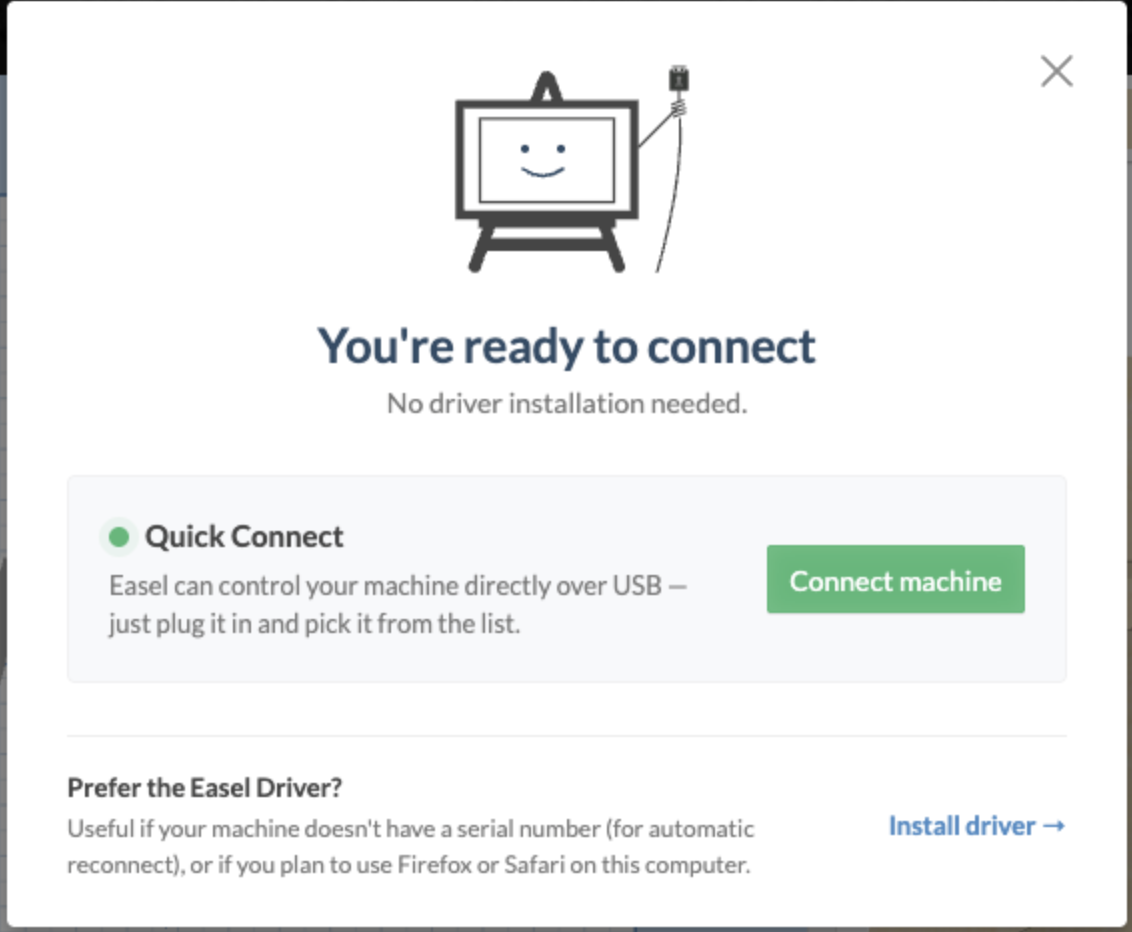

8. Connecting to Easel Without the Easel Driver
Overview
Easel can connect directly to compatible machines without requiring the Easel Driver. This option is useful for older computers, Chromebooks, or environments where installing software is not possible.
Important: Driverless connections are only supported in the following browsers:
- Google Chrome
- Microsoft Edge
- Opera
Before You Begin
To use a driverless connection, the Easel Driver must not be installed on your computer.
If the Easel Driver is currently installed:
- Uninstall the Easel Driver.
- Restart your computer to complete the removal process.
- Open Easel in a supported browser.
Connecting Your Machine
- Open Easel and click Carve.
- A new connection screen will appear.
- Click the green Connect Machine button.

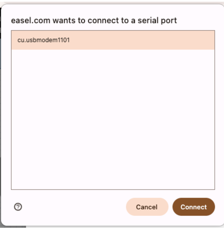

- Your browser will display a list of available ports and devices.
- Select your machine from the list.
- Click Connect to authorize Easel to communicate with the machine.
Once connected, you can begin carving as normal.
