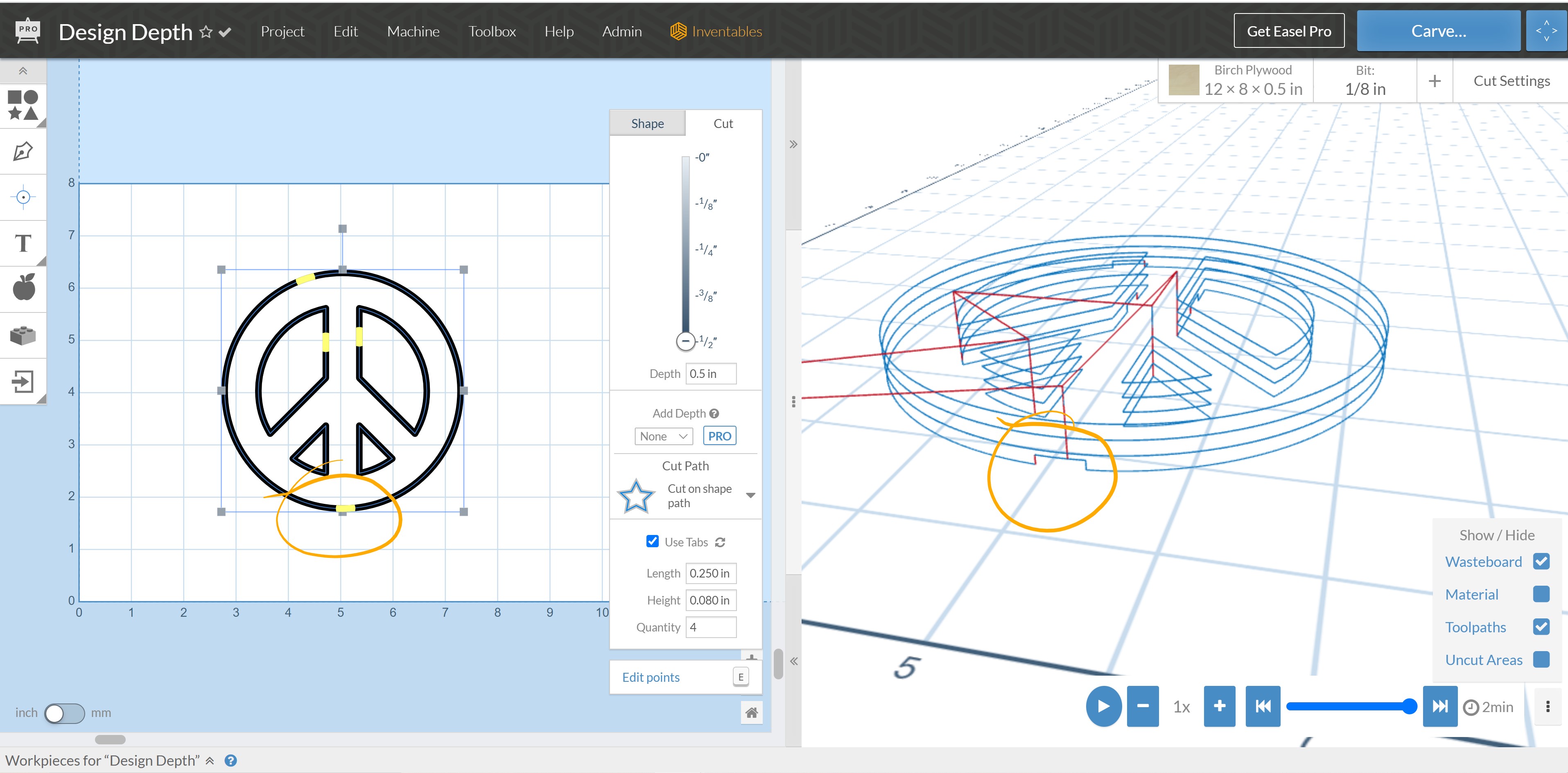

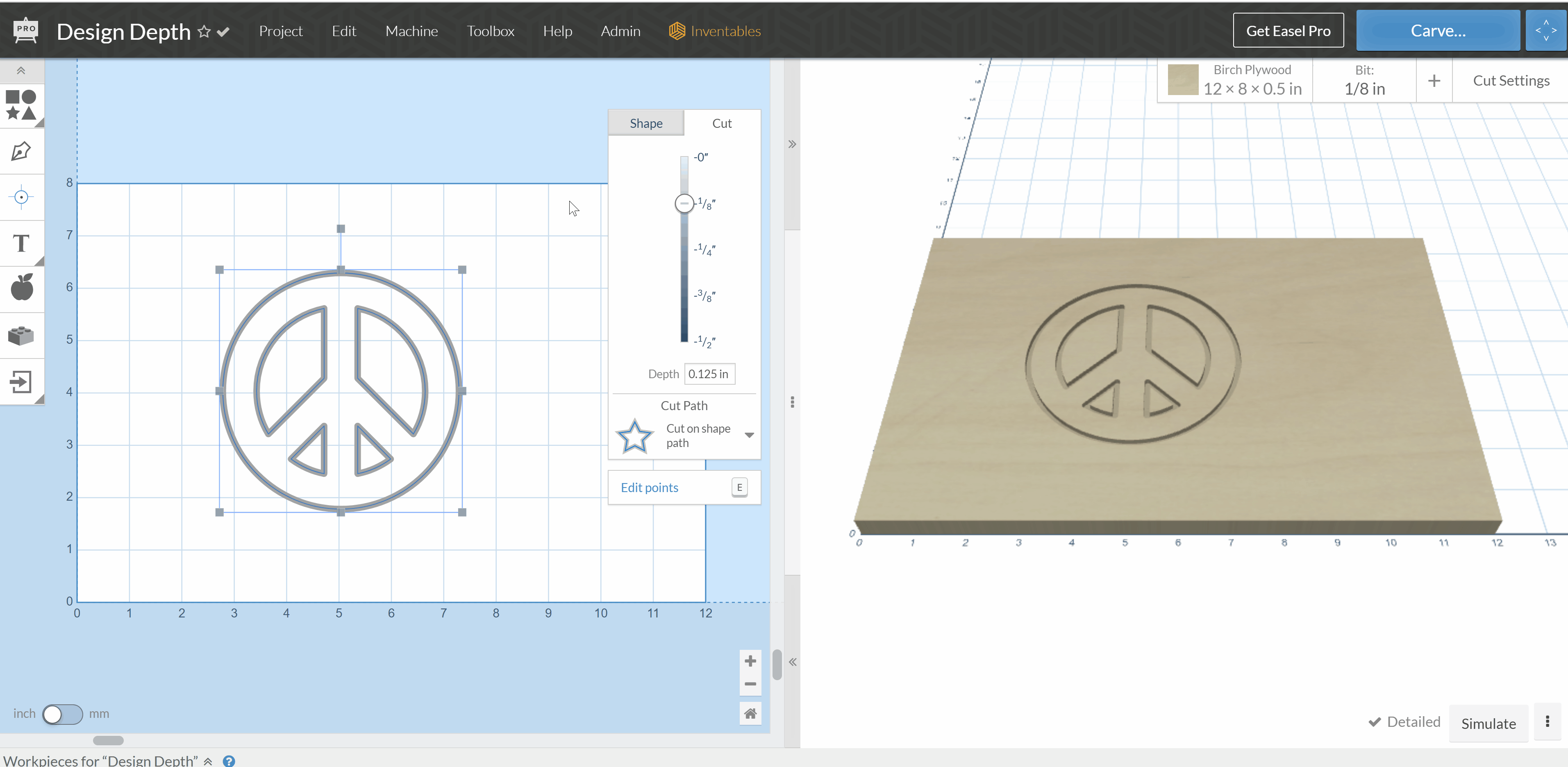

Once you've added an element to the 2D design editor, you can adjust the overall depth using the slider (1) in the Cut menu, or type an exact value in the Depth field (2). As you adjust the depth, notice the 3D view changes.

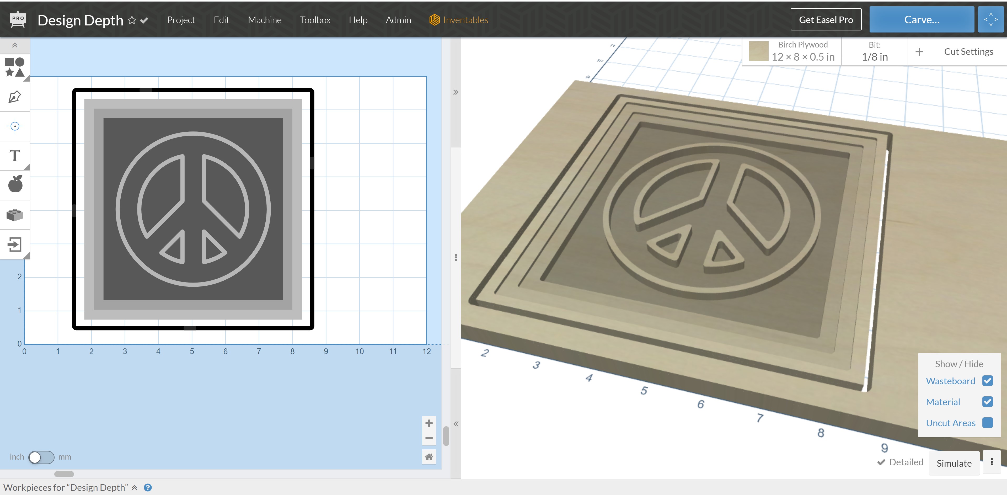

Creating layers
Here's an example of using shapes of varying layers of depth. The square (1) is carved deeper than the triangle (2) that sits on top of it.
To create layers, you need to select your shape and go to Edit > Send Backward or Send to Back, depending on what you want the design to look like. See Aligning and Combining Shapes.

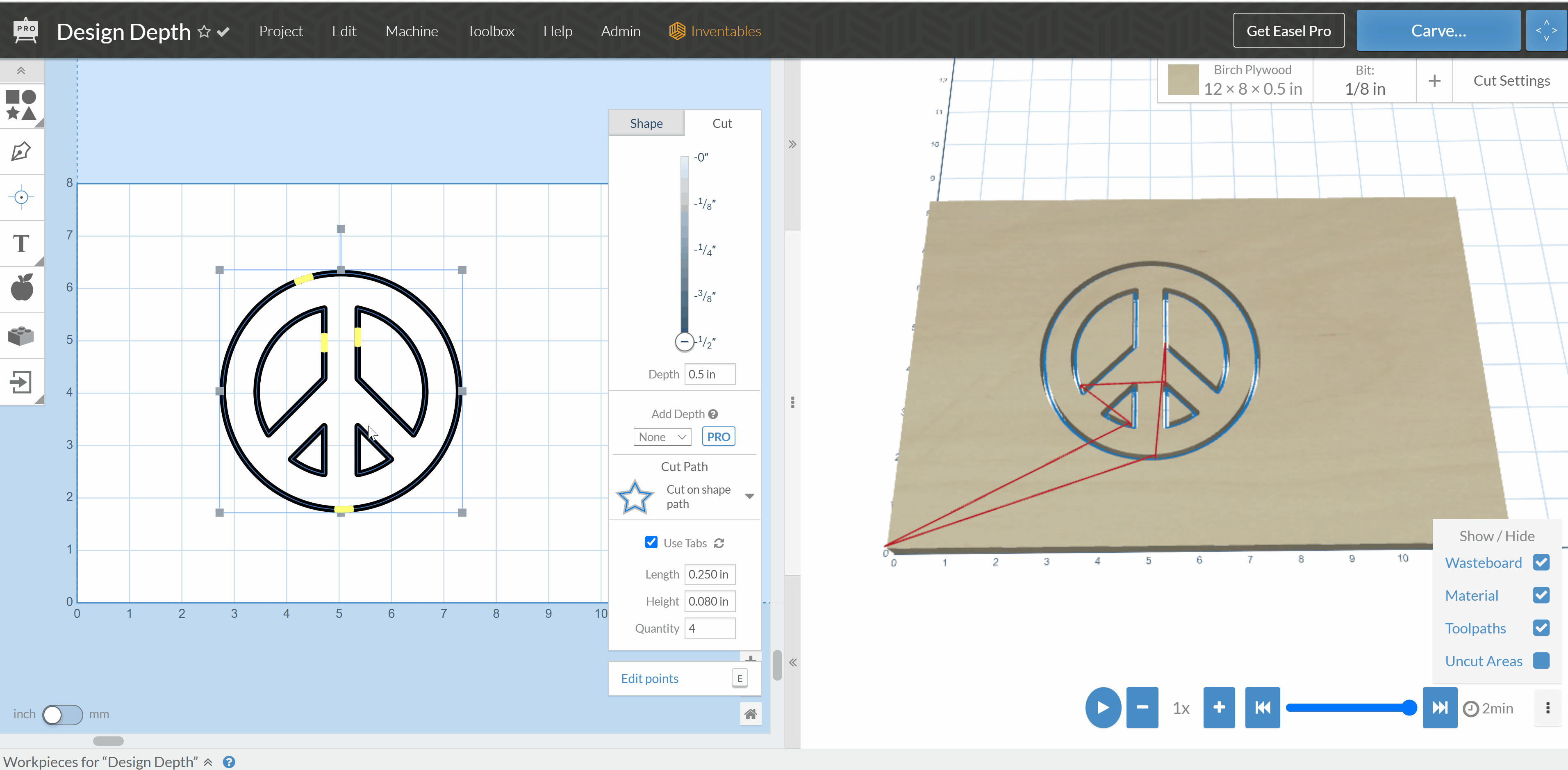

If your shape's depth goes all the way through your material, Easel will automatically add tabs for that shape. Tabs are small bits that extend from the shape and hold it in place. You can choose not to use tabs if you prefer.

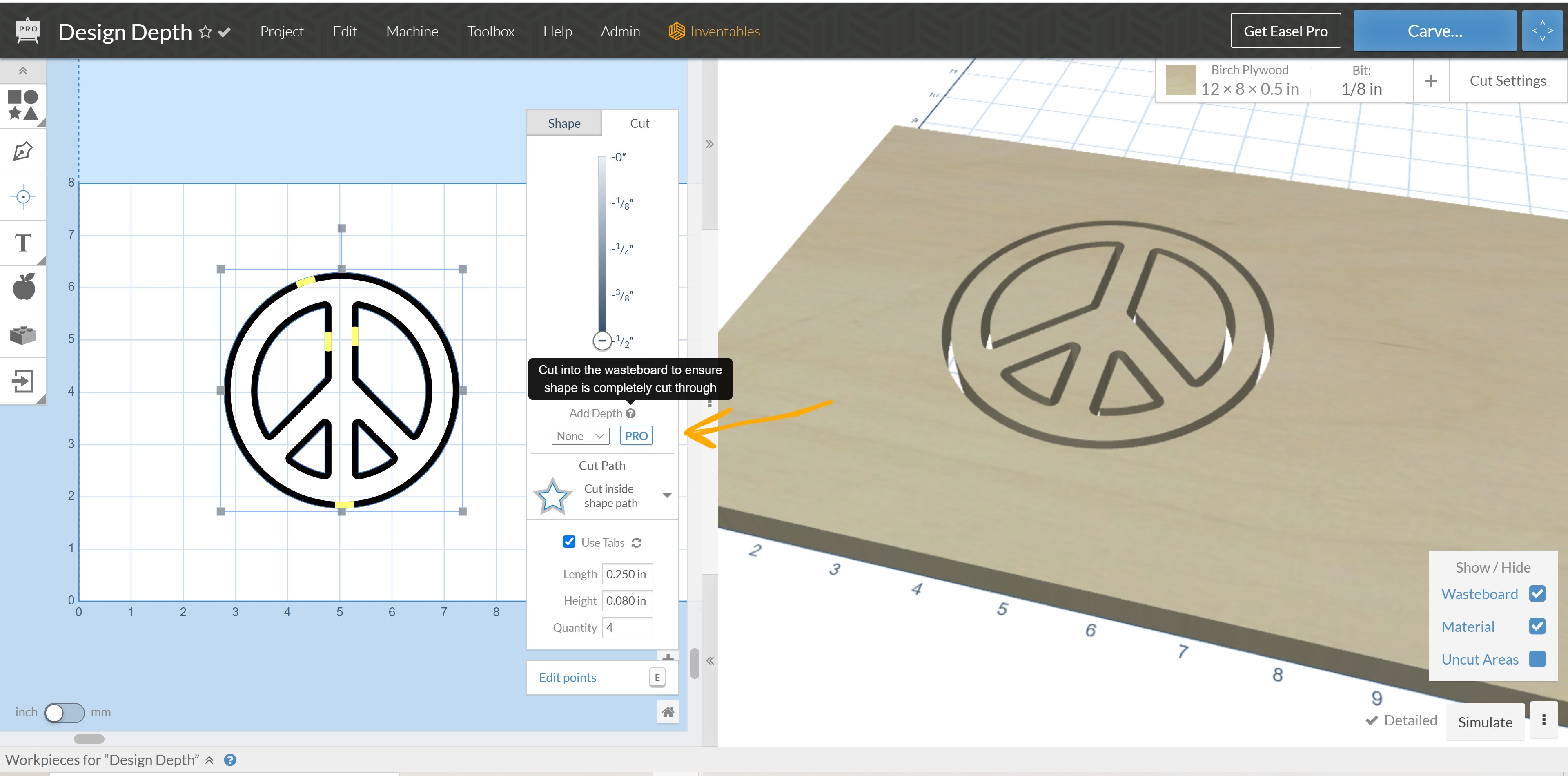

If you have Easel Pro, you can use Add Depth (2) to ensure your shape (1) is cut all the way through (3).

You can also use the Cut menu to change the Cut Type. There are 4 cut options:
- Clear out a pocket: "fill" type cut, will carve everything inside closed shapes
- Cut on shape path: "outline" type cut, the center of the bit moves along the shape path
- Cut outside shape path: "outline" type cut, the bit moves along the outside of the shape path
- Cut inside shape path: "outline" type cut, the bit moves on the inside of the shape path
