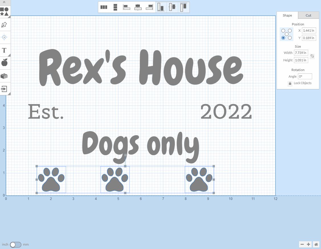

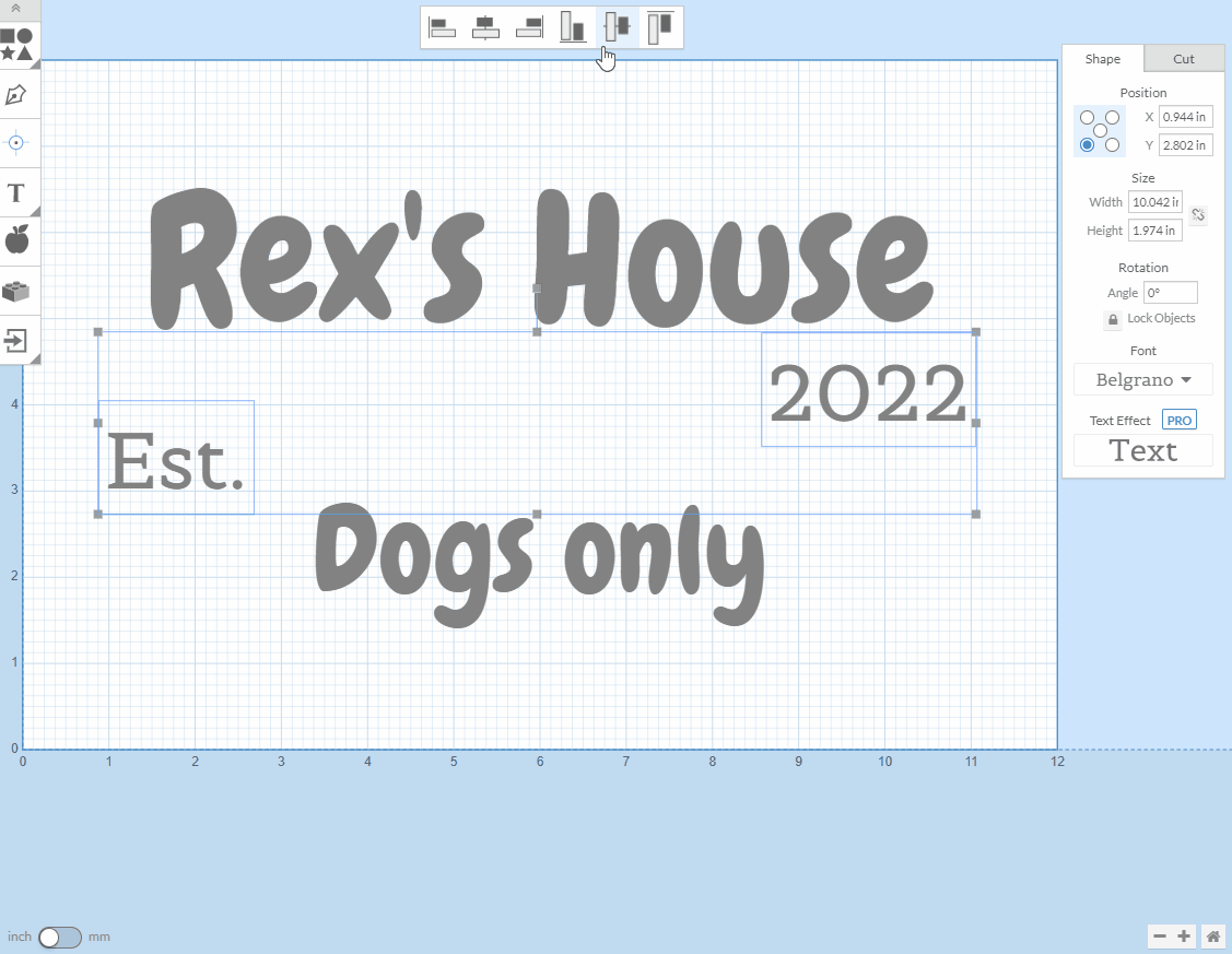

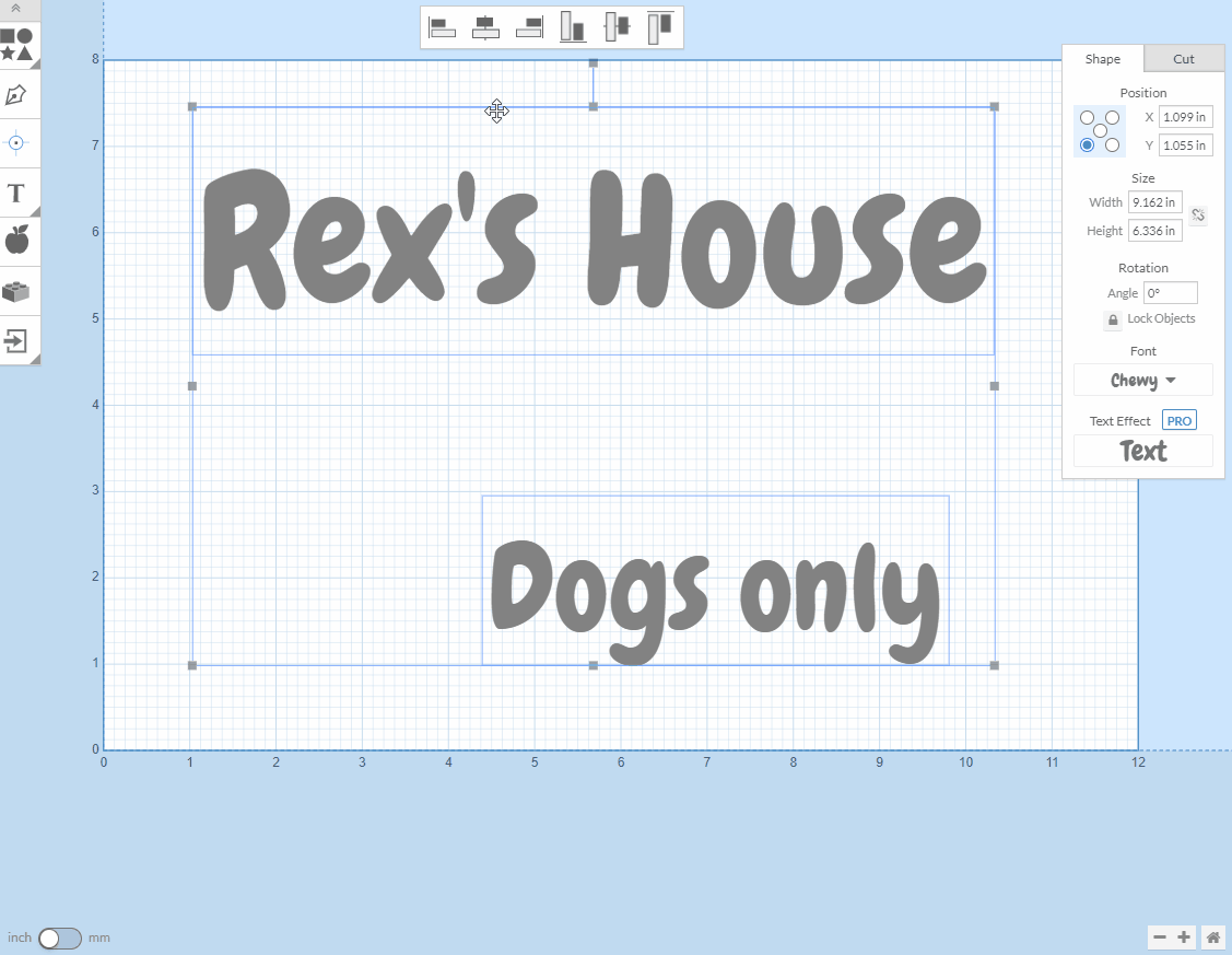

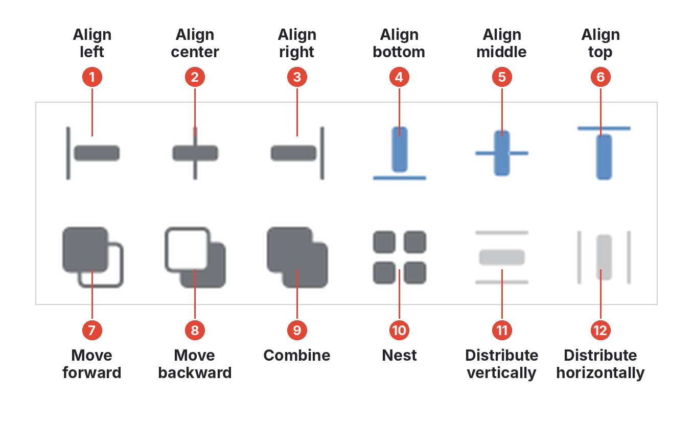

Select two or more shapes. The Alignment menu appears above the Shape and Cut tabs.
1–3. Align left, center and right
Line up the selected shapes along their left edges, their centers, or their right edges.
4–6. Align bottom, middle and top
Line up the selected shapes along their bottom edges, their middles, or their top edges.
7–8. Move forward and Move backward
Move the selected shape one layer above or below the other shapes in your design.
9. Combine
Join the selected shapes into a single shape.
10. Nest
Arrange the selected shapes to fit on your material. See Nest Shapes & Fill Material (Easel Pro).
11–12. Distribute vertically and horizontally
Space the selected shapes evenly from top to bottom, or from left to right.

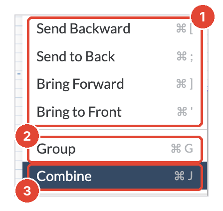

Using the Edit menu
The same options are in the Edit menu, along with their keyboard shortcuts.
- Layering (1): Send Backward (⌘ [), Send to Back (⌘ ;), Bring Forward (⌘ ]) and Bring to Front (⌘ ').
- Group (2, ⌘ G): keep shapes together so they move as one, while each stays its own shape.
- Combine (3, ⌘ J): join the selected shapes into a single shape.
On Windows, use Ctrl instead of ⌘.

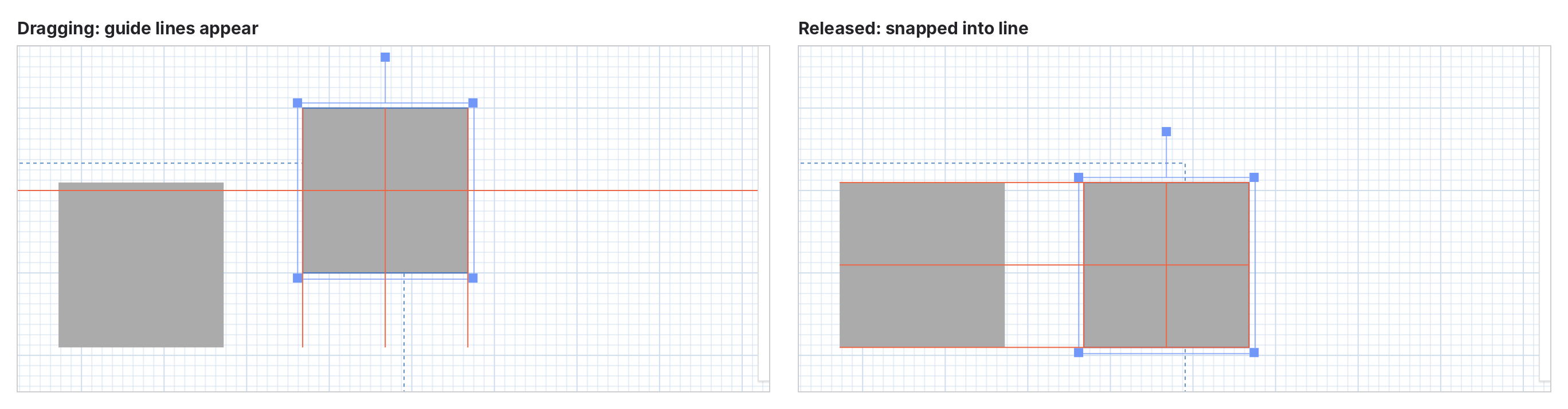

Snap alignment
When you drag a shape, guide lines appear as its center or edge gets close to the center or edge of another shape or of the material. Let go and the shape snaps into line with the guide. Guides also appear when you drag straight across or up and down, to keep the shape in line with where it started.
| Helpful Tip: To place a shape freely without snapping, hold Command (Mac) or Ctrl (Windows) while you drag. |
