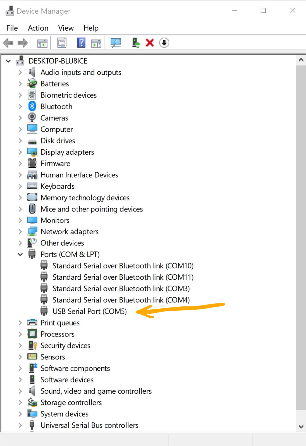

When your computer boots up again, go into your Device Manager (you should be able to search your computer for this program). If the driver works correctly, you should see something under Ports. It will give you a COM number and list the device.
Remember this COM number.
Helpful Tip:If nothing appears under Ports and you still see USB Device > Other Device in the Device Manager, the computer may not have been restarted after installing the FTDI driver. Restart the computer and check again. If the issue persists, verify that your USB cables are working properly. |

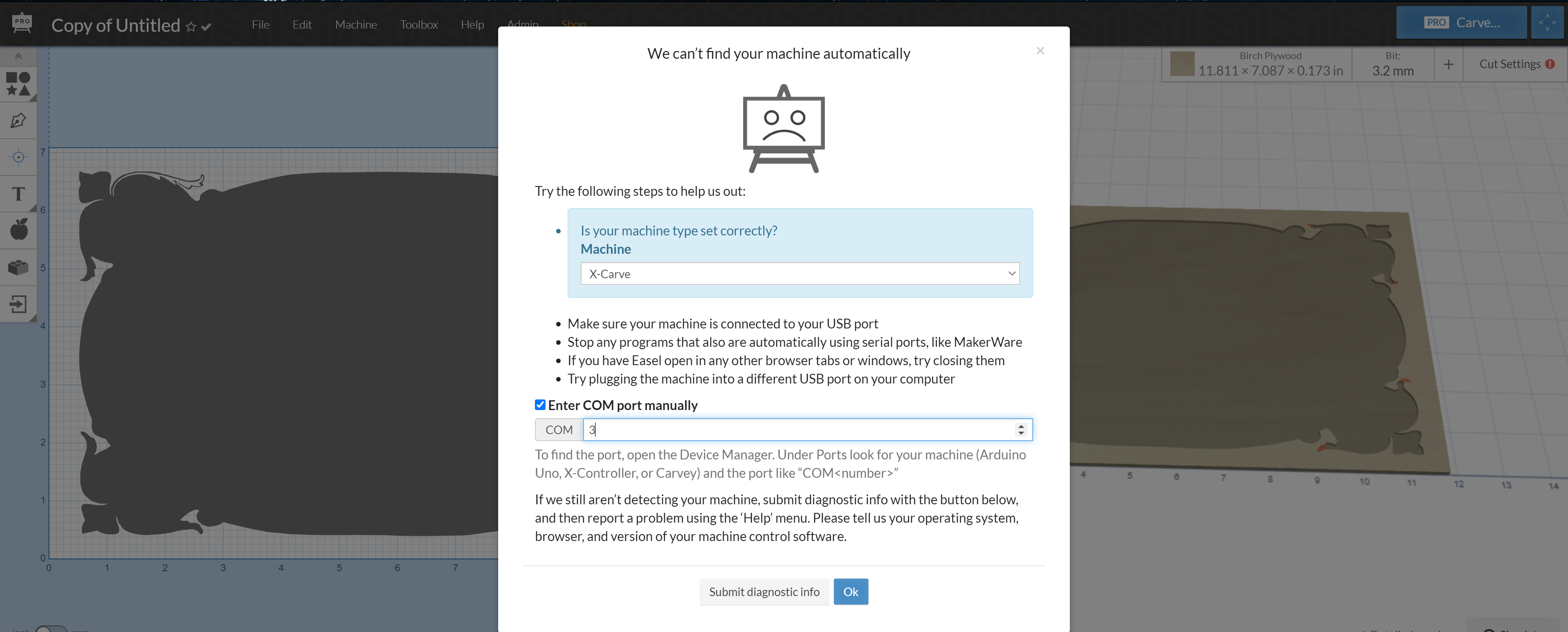

Once you do have the device showing up under the Ports section, go back into Easel Setup via Google Chrome (not Internet Explorer). Try connecting to your machine again. If you are prompted to enter the COM port manually, enter the number from the COM Port section in the Device Manager. For example, if the machine showed up in the Device Manager under COM Port 3, enter 3 in the box and hit enter.
