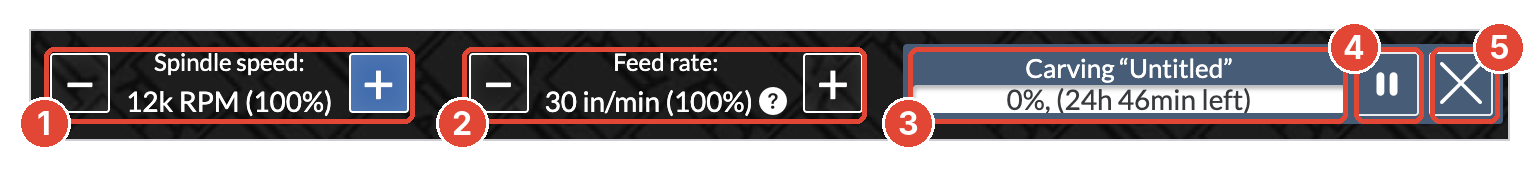

Go through the carve walkthrough and start your carve. While it carves, the carve controls appear at the top of Easel.
1. Spindle speed
Click + or − to change how fast your spindle spins. The percentage shows the speed compared to your cut settings.
2. Feed rate
Click + to speed up or − to slow down. The change happens right away, and the percentage shows the speed compared to your cut settings.
3. Progress
Shows how much of the carve is done and how much time is left.
4. Pause
Pauses the carve.
5. Stop
Stops the carve.
