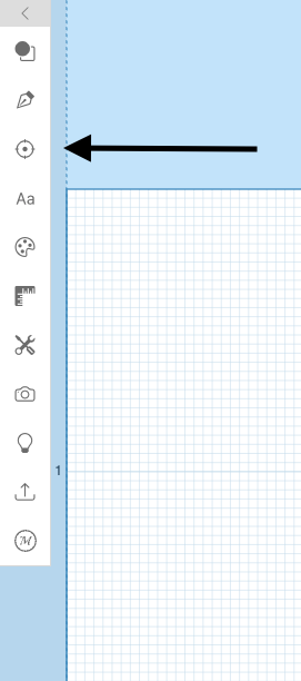

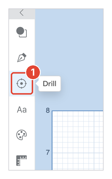

In the top toolbar, select the "drill hole" icon. This will add a drill hole to your work area.
Tips & Tricks: You can identify a drill hole in Easel by the distinct pattern around it. |

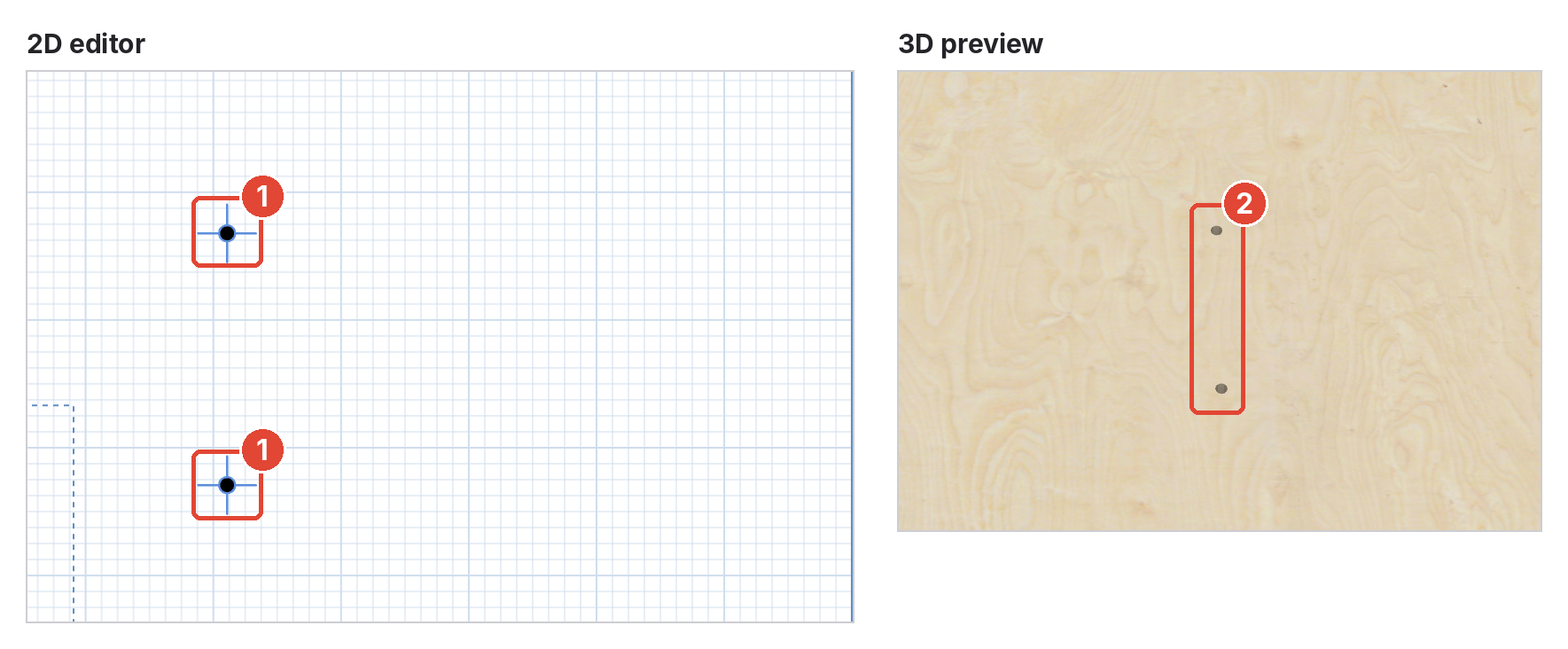

Once a drill hole is placed, set the depth of the hole in the Cut panel—just like you would for any other shape.
| Tips & Tricks: You can use the alignment tools to make sure your drill holes are placed in the right spot. |
| Important Info: The size of the drill hole will adjust with the size of the bit you are using to carve with. |
Drill holes have special toolpaths, enabling you to use milling bits for this feature instead of drill bits. Easel will direct your machine to cut in a vertical motion, raising the bit out of the material after each plunge at the depth per pass. This allows chips (the material removed from the hole) to escape, reducing stress on the bit and minimizing heat built up.

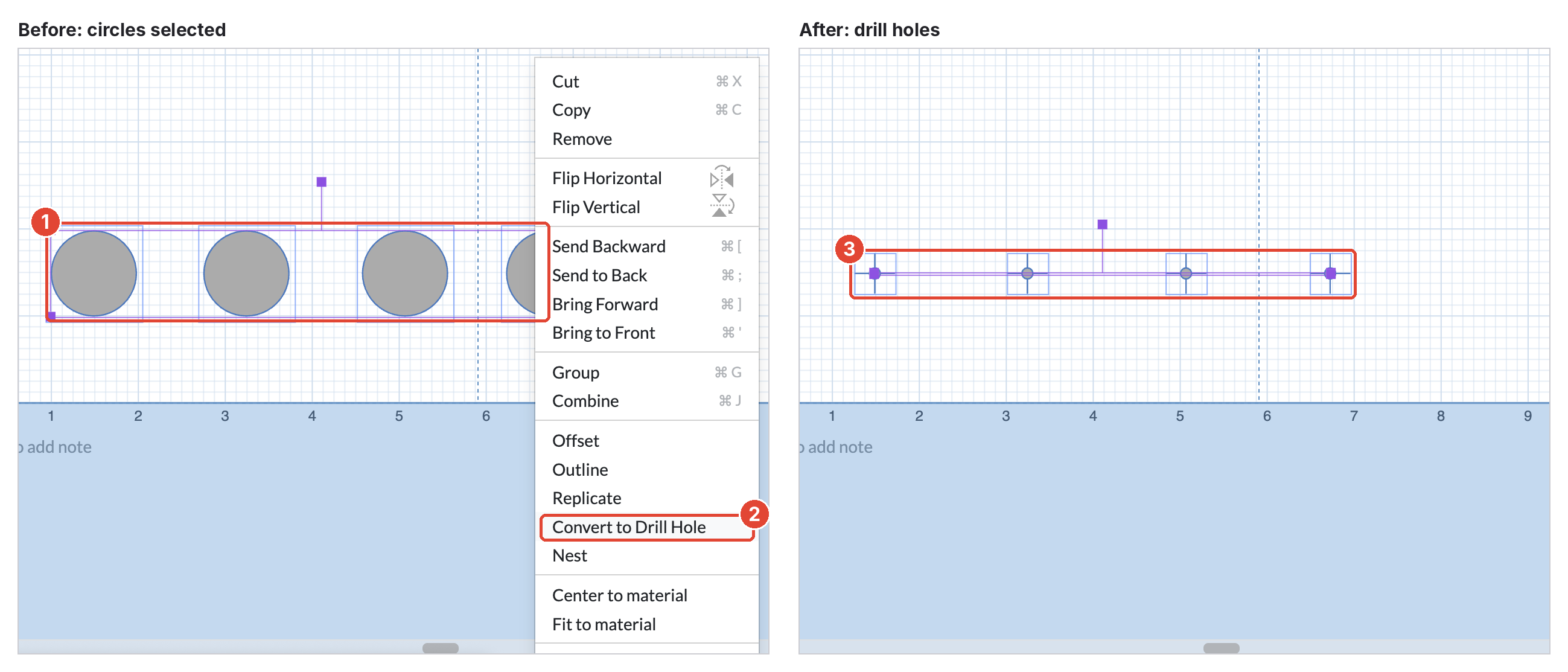

Advance Use: Circles to Drill Holes
At times, it may be necessary to convert a large number of circles in a project to drill holes. This use case will walk you through converting circle carvings into drill holes. You can check out this quick video walkthrough of the process using the link below.
