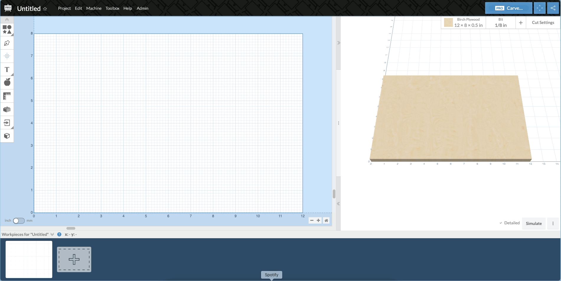

If you still have issues, you may need to do a firmware reset from the Machine Inspector.
Open up the Machine Inspector by going to Machine > General Settings> Machine Inspector.
In the Machine Inspector scroll down to the console and send this command:
