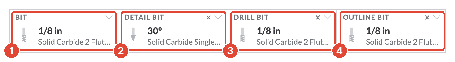

Adding bits
Click + next to the Bit menu to add another bit. You can use up to four bits on a project:
- Bit: your roughing bit, which carves as much of the design as possible.
- Detail Bit: a smaller bit for the intricate parts the roughing bit can't reach.
- Drill Bit: carves the drill holes in your design.
- Outline Bit: carves the outlines and cutouts in your design.
Click × on a bit menu to remove that bit.
