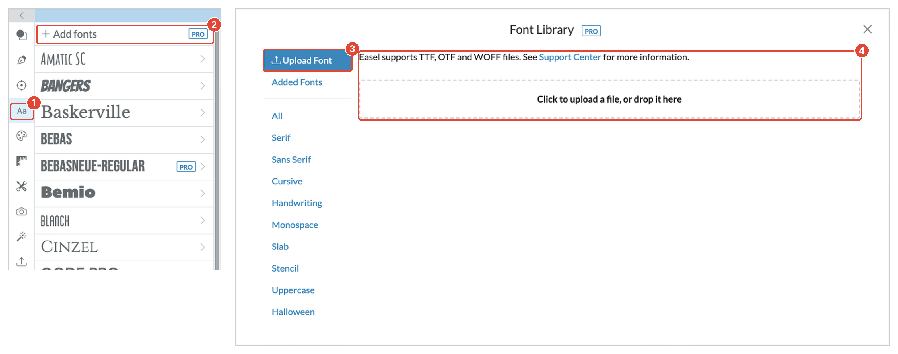

With an Easel Pro subscription, you will find a tab in the Font Library named “Upload Font”, allowing you to attach and use custom fonts in your designs. See the video below for a walkthrough of how to use this feature!

Visit the Custom Fonts Feature and enroll by clicking the button. When you return to Easel, you will see a new tab in the Font Library labeled “Upload Font.”
What kind of fonts can I use?
Easel will accept TTF, OTF, and WOFF file types. Please note, some files may carve better than others.
