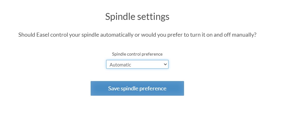

All Two Trees machines have an automatic spindle. If the spindle is not coming on it may need to be enabled.
You can enable this setting by setting up your machine properly. Go to Machine > Set up new machine and select Other (3rd Party Machine).
Follow the prompts in the walkthrough and during the "Spindle Settings" step, select Automatic.
Easel will prompt you to test the spindle to make sure it works.
Continue to the Machine Setup until you finish. You should now be configured for the spindle to turn on before a carve.
If it still does not work, you can go to Machine > Edit your machine and change the Spindle controlled by to Hardware. The Spindle should be set to "Other" and Default Spindle RPM set to your manufacturer's recommended RPM values.
