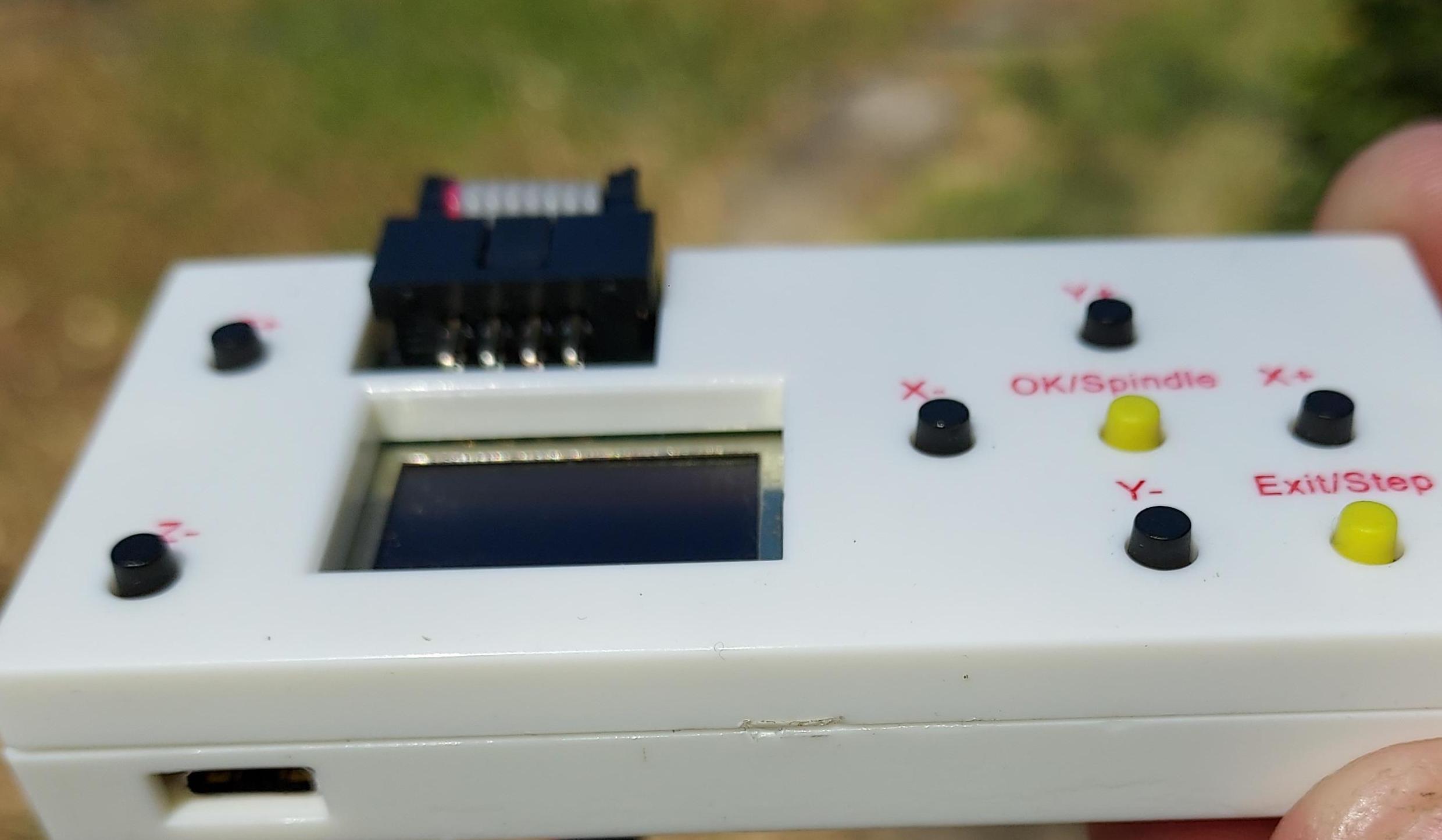

Two Trees machines come with offline controllers (see image below) and this prevents your computer from connecting to Easel. To connect directly to Easel, you must disconnect your offline controller.
If you want to use your offline controller, you can always try exporting g-code from Easel. That process is outlined here:
Non-Grbl Machine Setup (OEM Partner Machine)
