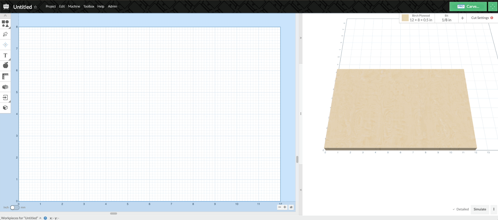

To resolve the stopping issue, you could try disabling soft or hard limits by changing the $20 (Soft Limits) or $21 (Hard Limits) value from Easel's Machine Inspector console.
You can open up the Machine Inspector by going to Machine > General Settings > Machine Inspector. In the Console, you can disable hard limits by typing one of the following commands:
$20=0
$21=0
Press Enter. You should receive the "OK" message.
You can now exit the Machine Inspector and try carving again.
