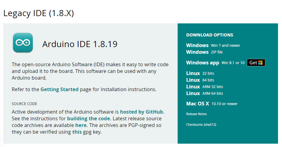

The first step is to download the Arduino IDE. Head over to the Arduino downloads page and scroll down to install the Legacy IDE Arduino IDE 1.8.19 that works with your operating system.

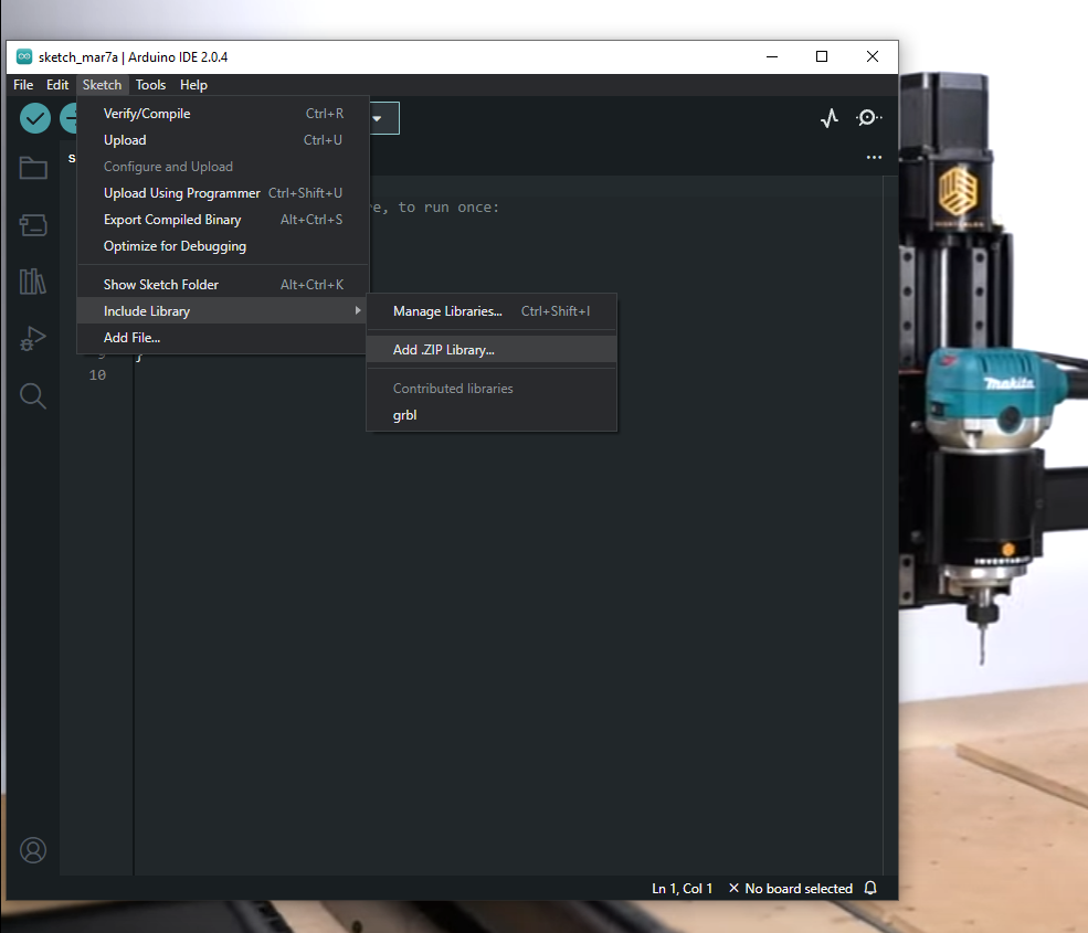

Open Arduino to add the Grbl library to your Arduino IDE, and navigate to Sketch - Include Library - Add .ZIP Library.
Choose the gCarvin.zip file.
