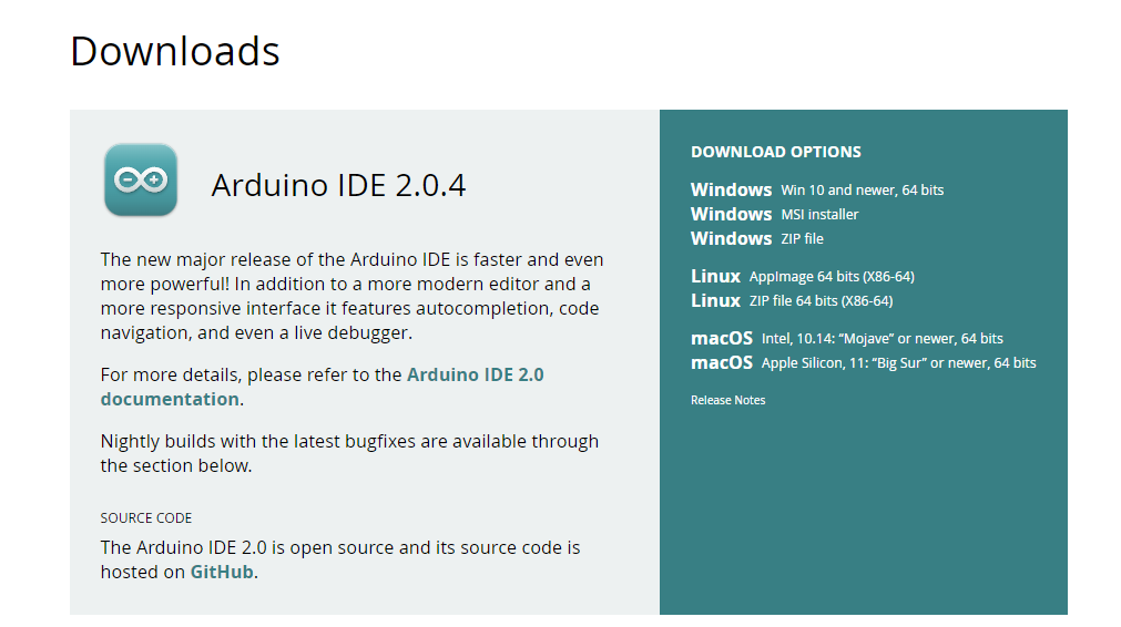

Head over to the Arduino downloads page and scroll down to install the Arduino IDE 2.0.4. You will click on "Windows: Win 10 and Newer".

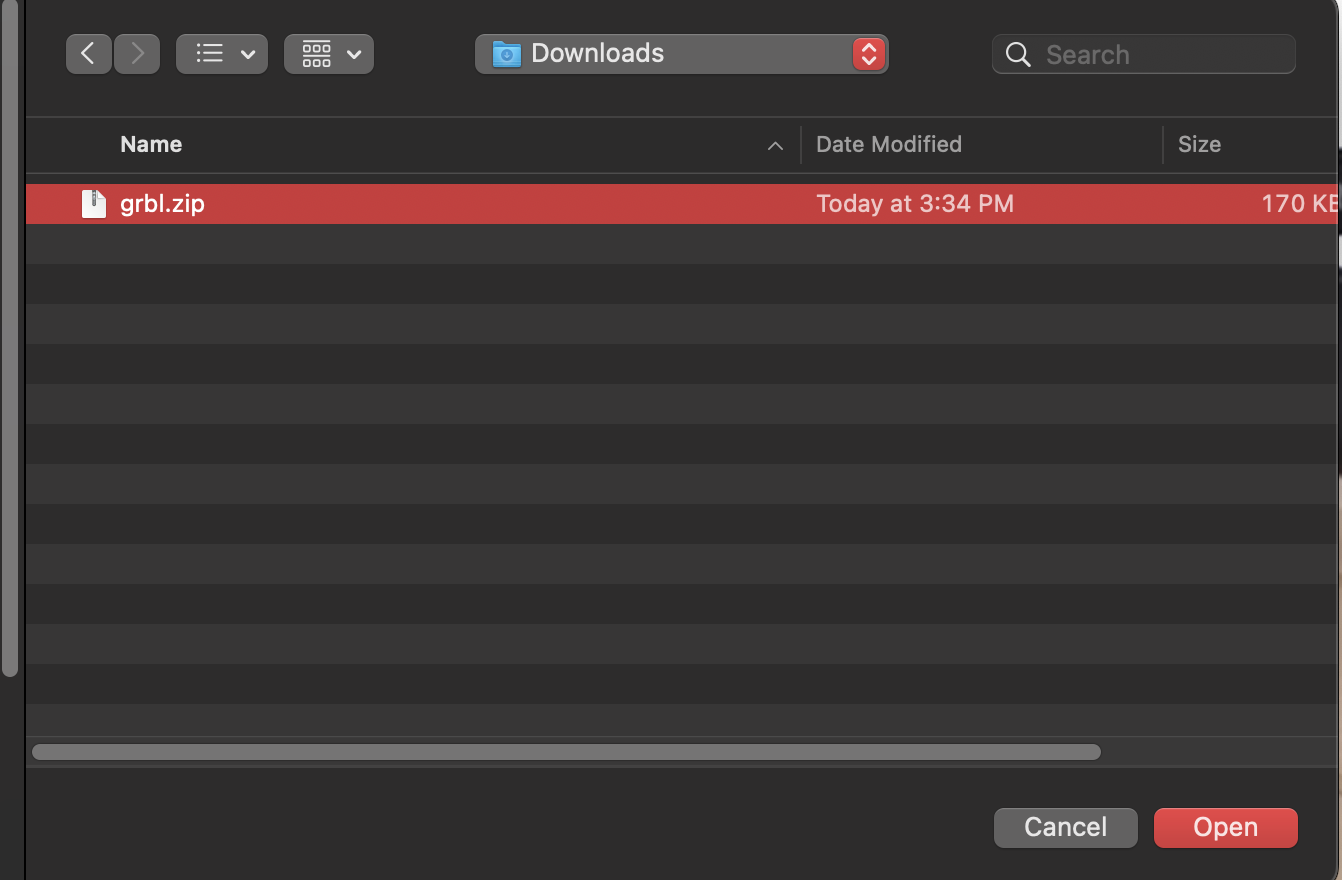

Locate the file where you saved it (likely the downloads folder) and remember where they are located on your computer, because you will need to access this Zip Folder in the next step.

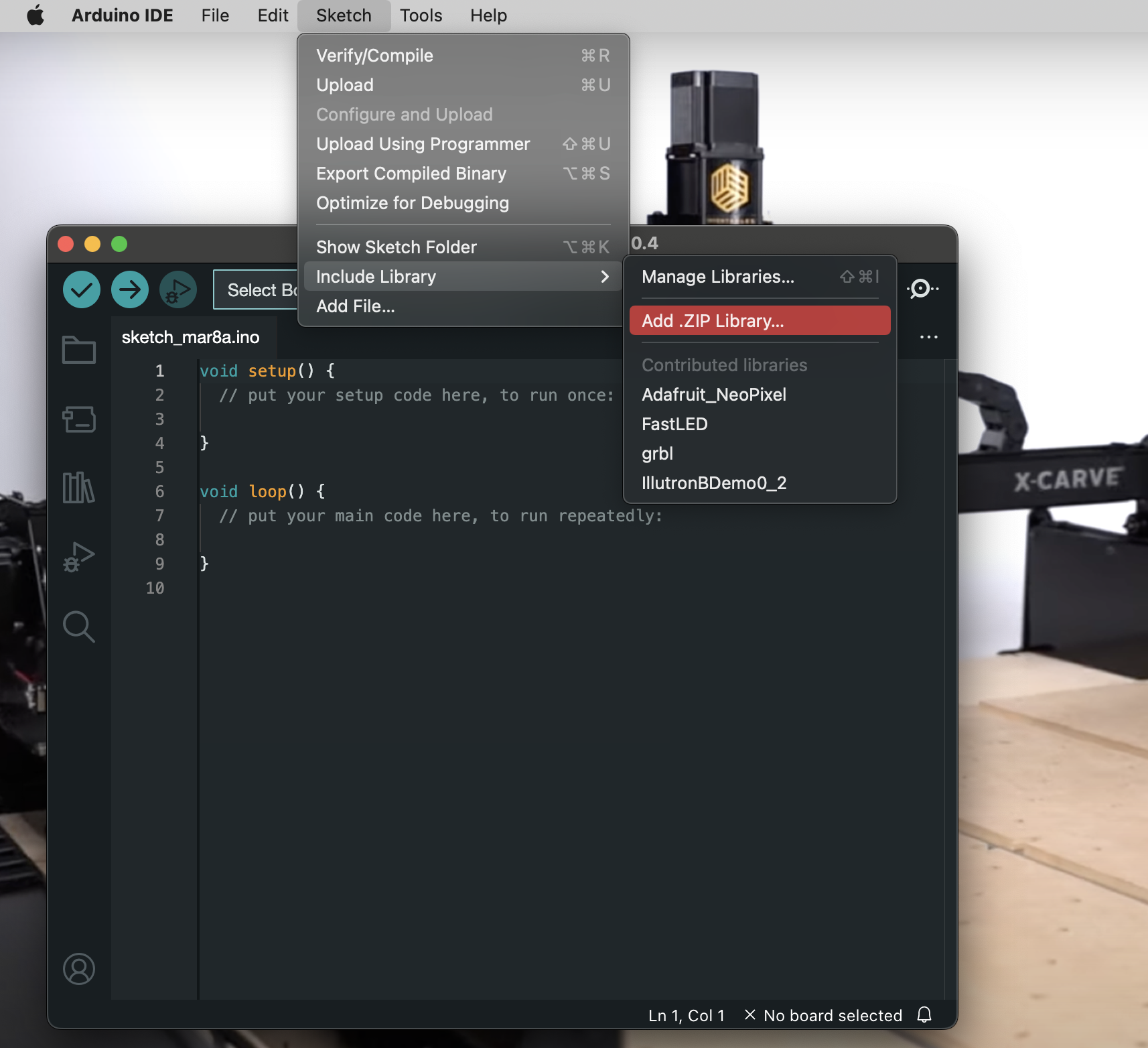

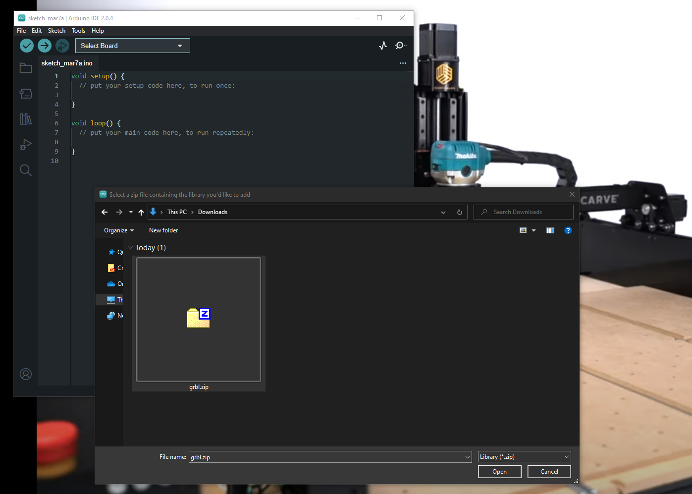

Open Arduino to add the Grbl library to your Arduino IDE, and navigate to Sketch - Include Library - Add .ZIP Library...
Choose the grbl.zip file.
After clicking on the "Open" button, you should receive a confirmation in the IDE Output saying "Library Installed"

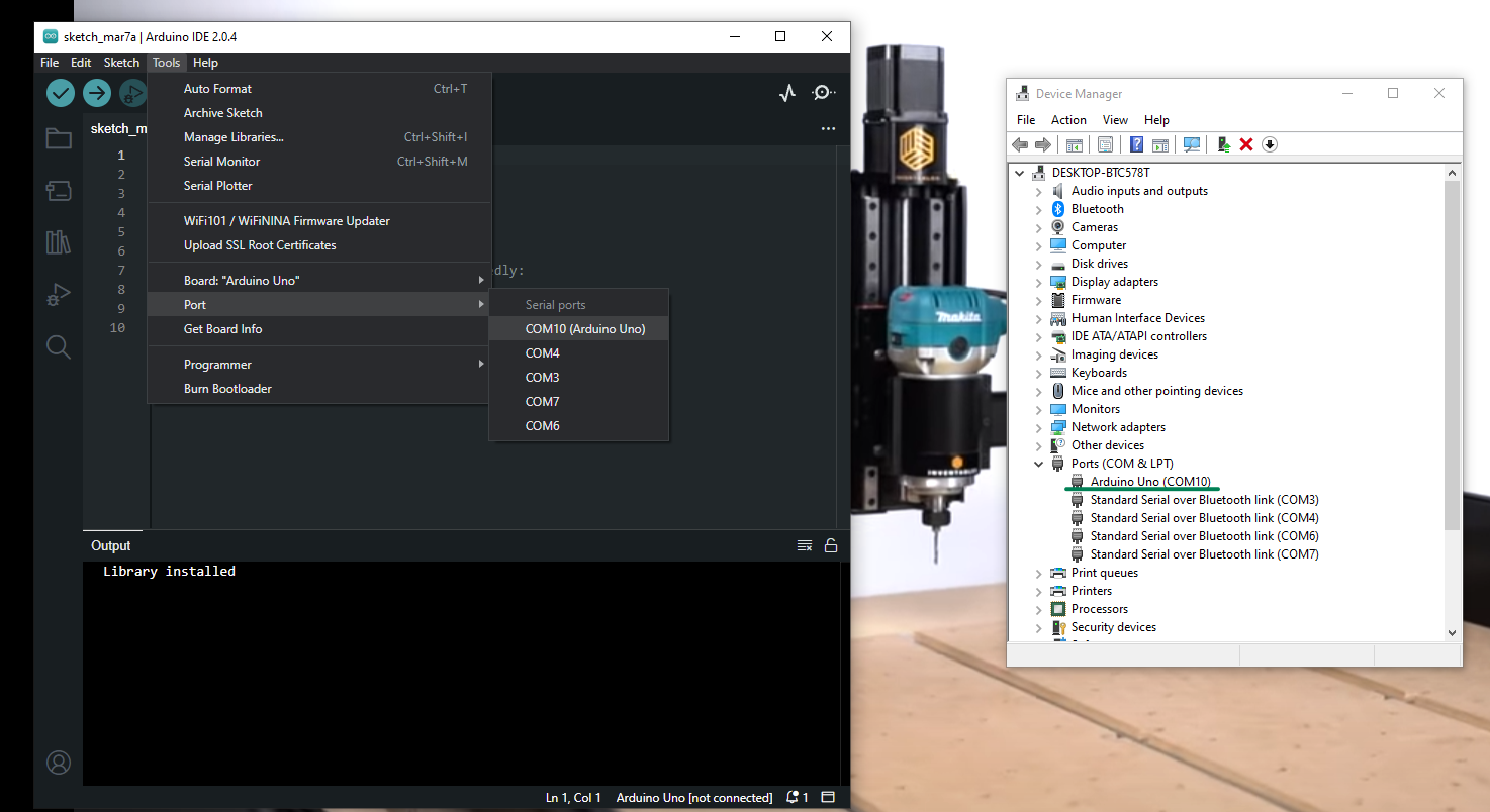

Next, make sure you have your board plugged in and selected under Tools - Port - port name(Arduino Uno). For PC users, you can verify the Port by checking in your computer's Device Manager.

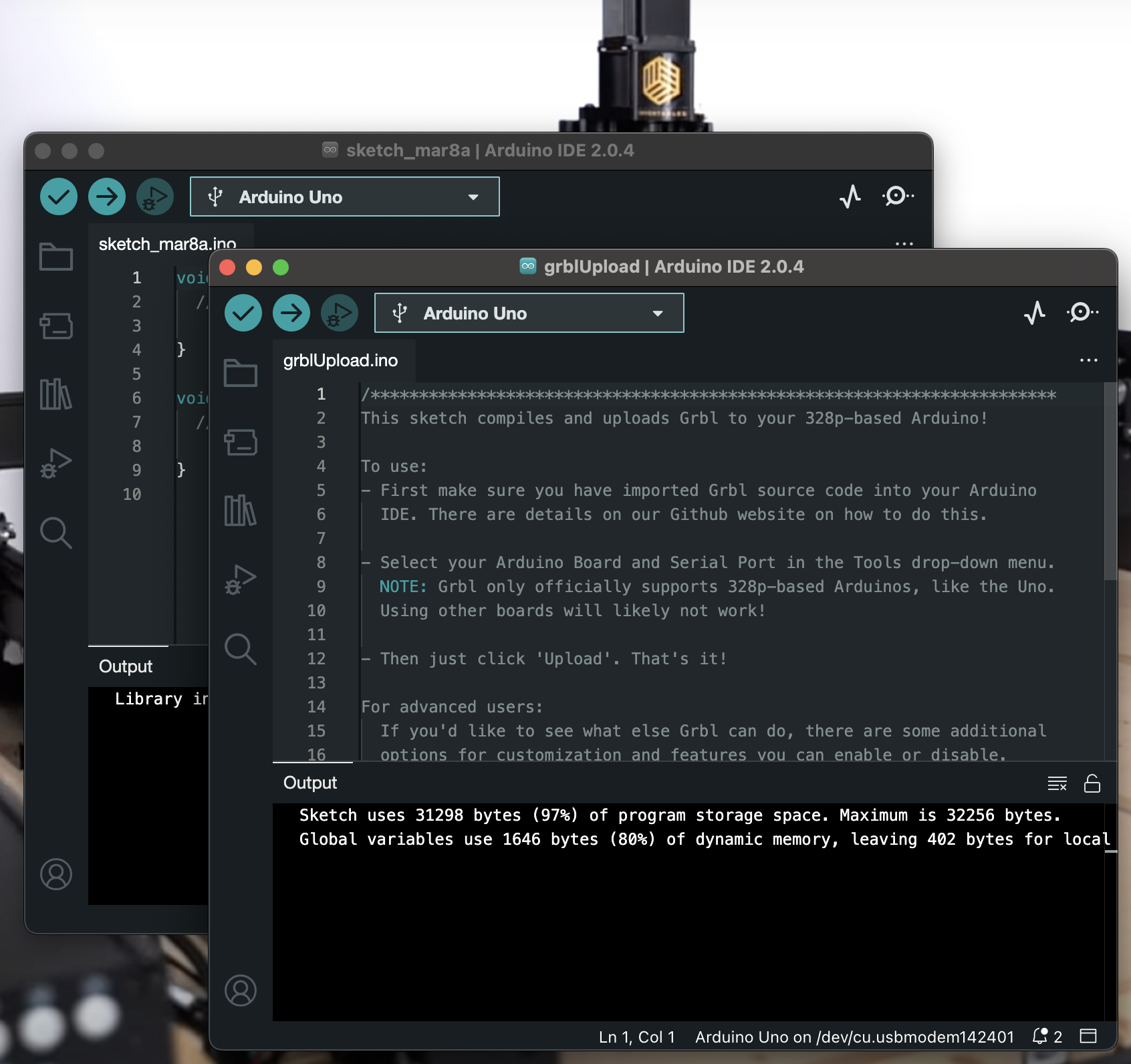

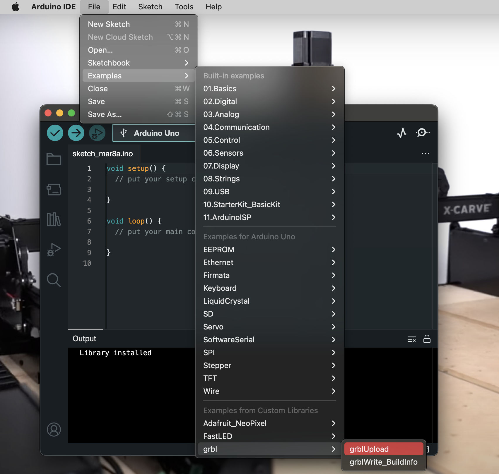

Navigate to the grblUpload sketch under File - Examples - grbl - grblUpload.

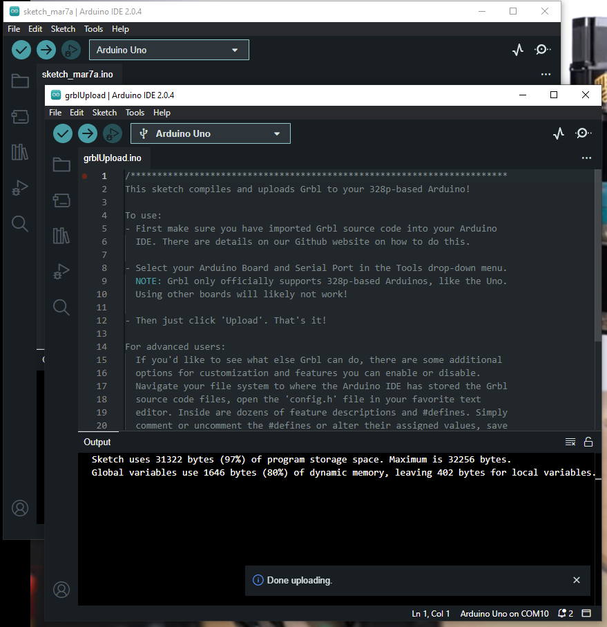

Click on the arrow icon in the top lefthand corner of the window to upload.
Congrats! You've successfully re-flashed! Now make sure to go through the Easel Setup Walkthrough to configure your machine.
After clicking on the "Open" button, you should receive a confirmation in the IDE saying "Library Installed."
Click on the arrow icon in the top lefthand corner of the window to upload.Congrats! You've successfully re-flashed! Now make sure to go through the Easel Setup Walkthrough to configure your machine.
